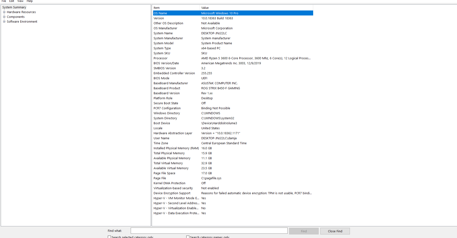

    I have a freshly build PC with the following configuration: First pic bellow

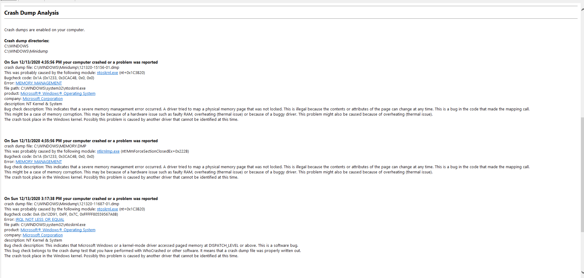

    I have had troubles with some blue screen of death errors these days second picture bellow WhoCrashed
    Then I updated my drivers and the errors reduced but i still have cracking sound and video and audio out of sync when playing live videos Youtube.

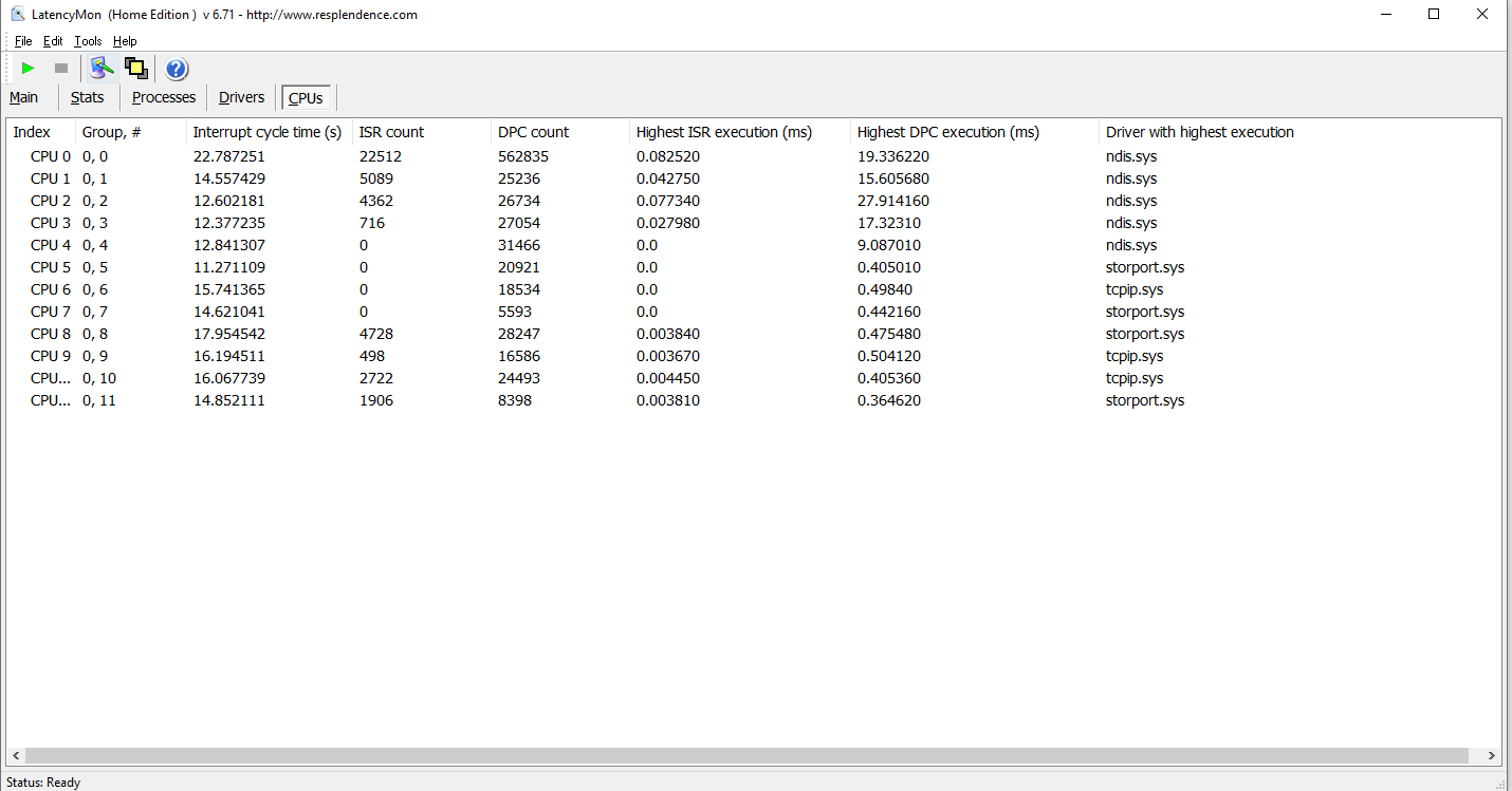

    Then I ran LatencyMon and the results were:
    CONCLUSION
    _________________________________________________________________________________________________________
    Your system appears to be having trouble handling real-time audio and other tasks. You are likely to experience buffer underruns appearing as drop outs, clicks or pops. One or more DPC routines that belong to a driver running in your system appear to be executing for too long. At least one detected problem appears to be network related. In case you are using a WLAN adapter, try disabling it to get better results. One problem may be related to power management, disable CPU throttling settings in Control Panel and BIOS setup. Check for BIOS updates.
    LatencyMon has been analyzing your system for 0:05:22 h:mm:ss on all processors.
    SYSTEM INFORMATION
    Computer name: DESKTOP-JNJ22LC
    OS version: Windows 10 , 10.0, build: 18363 x64
    Hardware: ASUSTeK COMPUTER INC., ROG STRIX B450-F GAMING
    CPU: AuthenticAMD AMD Ryzen 5 3600 6-Core Processor
    Logical processors: 12
    Processor groups: 1
    RAM: 16310 MB total
    CPU SPEED
    Reported CPU speed: 360 MHz
    Note: reported execution times may be calculated based on a fixed reported CPU speed. Disable variable speed settings like Intel Speed Step and AMD Cool N Quiet in the BIOS setup for more accurate results.
    WARNING: the CPU speed that was measured is only a fraction of the CPU speed reported. Your CPUs may be throttled back due to variable speed settings and thermal issues. It is suggested that you run a utility which reports your actual CPU frequency and temperature.
    MEASURED INTERRUPT TO USER PROCESS LATENCIES
    The interrupt to process latency reflects the measured interval that a usermode process needed to respond to a hardware request from the moment the interrupt service routine started execution. This includes the scheduling and execution of a DPC routine, the signaling of an event and the waking up of a usermode thread from an idle wait state in response to that event.
    Highest measured interrupt to process latency µs: 20613.10
    Average measured interrupt to process latency µs: 10.653466
    Highest measured interrupt to DPC latency µs: 20607.40
    Average measured interrupt to DPC latency µs: 6.332420
    REPORTED ISRs
    Interrupt service routines are routines installed by the OS and device drivers that execute in response to a hardware interrupt signal.
    Highest ISR routine execution time µs: 82.520
    Driver with highest ISR routine execution time: ntoskrnl.exe - NT Kernel & System, Microsoft Corporation
    Highest reported total ISR routine time %: 0.007934
    Driver with highest ISR total time: ntoskrnl.exe - NT Kernel & System, Microsoft Corporation
    Total time spent in ISRs % 0.008587
    ISR count execution time <250 µs: 42533
    ISR count execution time 250-500 µs: 0
    ISR count execution time 500-999 µs: 0
    ISR count execution time 1000-1999 µs: 0
    ISR count execution time 2000-3999 µs: 0
    ISR count execution time >=4000 µs: 0
    REPORTED DPCs
    DPC routines are part of the interrupt servicing dispatch mechanism and disable the possibility for a process to utilize the CPU while it is interrupted until the DPC has finished execution.
    Highest DPC routine execution time µs: 27914.160
    Driver with highest DPC routine execution time: ndis.sys - Network Driver Interface Specification NDIS, Microsoft Corporation
    Highest reported total DPC routine time %: 0.141193
    Driver with highest DPC total execution time: Wdf01000.sys - Kernel Mode Driver Framework Runtime, Microsoft Corporation
    Total time spent in DPCs % 0.444652
    DPC count execution time <250 µs: 778750
    DPC count execution time 250-500 µs: 0
    DPC count execution time 500-999 µs: 17048
    DPC count execution time 1000-1999 µs: 121
    DPC count execution time 2000-3999 µs: 60
    DPC count execution time >=4000 µs: 0
    REPORTED HARD PAGEFAULTS
    Hard pagefaults are events that get triggered by making use of virtual memory that is not resident in RAM but backed by a memory mapped file on disk. The process of resolving the hard pagefault requires reading in the memory from disk while the process is interrupted and blocked from execution.
    NOTE: some processes were hit by hard pagefaults. If these were programs producing audio, they are likely to interrupt the audio stream resulting in dropouts, clicks and pops. Check the Processes tab to see which programs were hit.
    Process with highest pagefault count: perfwatson2.exe
    Total number of hard pagefaults 27194
    Hard pagefault count of hardest hit process: 18795
    Number of processes hit: 21
    PER CPU DATA
    CPU 0 Interrupt cycle time s: 22.787251
    CPU 0 ISR highest execution time µs: 82.520
    CPU 0 ISR total execution time s: 0.156466
    CPU 0 ISR count: 22512
    CPU 0 DPC highest execution time µs: 19336.220
    CPU 0 DPC total execution time s: 8.666823
    CPU 0 DPC count: 562835
    CPU 1 Interrupt cycle time s: 14.557429
    CPU 1 ISR highest execution time µs: 42.750
    CPU 1 ISR total execution time s: 0.081105
    CPU 1 ISR count: 5089
    CPU 1 DPC highest execution time µs: 15605.680
    CPU 1 DPC total execution time s: 1.622277
    CPU 1 DPC count: 25236
    CPU 2 Interrupt cycle time s: 12.602182
    CPU 2 ISR highest execution time µs: 77.340
    CPU 2 ISR total execution time s: 0.075728
    CPU 2 ISR count: 4362
    CPU 2 DPC highest execution time µs: 27914.160
    CPU 2 DPC total execution time s: 1.429423
    CPU 2 DPC count: 26734
    CPU 3 Interrupt cycle time s: 12.377236
    CPU 3 ISR highest execution time µs: 27.980
    CPU 3 ISR total execution time s: 0.009545
    CPU 3 ISR count: 716
    CPU 3 DPC highest execution time µs: 17323.10
    CPU 3 DPC total execution time s: 0.434953
    CPU 3 DPC count: 27054
    CPU 4 Interrupt cycle time s: 12.841308
    CPU 4 ISR highest execution time µs: 0.0
    CPU 4 ISR total execution time s: 0.0
    CPU 4 ISR count: 0
    CPU 4 DPC highest execution time µs: 9087.010
    CPU 4 DPC total execution time s: 0.696490
    CPU 4 DPC count: 31466
    CPU 5 Interrupt cycle time s: 11.271110
    CPU 5 ISR highest execution time µs: 0.0
    CPU 5 ISR total execution time s: 0.0
    CPU 5 ISR count: 0
    CPU 5 DPC highest execution time µs: 405.010
    CPU 5 DPC total execution time s: 0.443916
    CPU 5 DPC count: 20921
    CPU 6 Interrupt cycle time s: 15.741365
    CPU 6 ISR highest execution time µs: 0.0
    CPU 6 ISR total execution time s: 0.0
    CPU 6 ISR count: 0
    CPU 6 DPC highest execution time µs: 498.40
    CPU 6 DPC total execution time s: 0.512179
    CPU 6 DPC count: 18534
    CPU 7 Interrupt cycle time s: 14.621041
    CPU 7 ISR highest execution time µs: 0.0
    CPU 7 ISR total execution time s: 0.0
    CPU 7 ISR count: 0
    CPU 7 DPC highest execution time µs: 442.160
    CPU 7 DPC total execution time s: 0.189971
    CPU 7 DPC count: 5593
    CPU 8 Interrupt cycle time s: 17.954542
    CPU 8 ISR highest execution time µs: 3.840
    CPU 8 ISR total execution time s: 0.003874
    CPU 8 ISR count: 4728
    CPU 8 DPC highest execution time µs: 475.480
    CPU 8 DPC total execution time s: 1.647292
    CPU 8 DPC count: 28247
    CPU 9 Interrupt cycle time s: 16.194511
    CPU 9 ISR highest execution time µs: 3.670
    CPU 9 ISR total execution time s: 0.000506
    CPU 9 ISR count: 498
    CPU 9 DPC highest execution time µs: 504.120
    CPU 9 DPC total execution time s: 0.810674
    CPU 9 DPC count: 16586
    CPU 10 Interrupt cycle time s: 16.067740
    CPU 10 ISR highest execution time µs: 4.450
    CPU 10 ISR total execution time s: 0.002527
    CPU 10 ISR count: 2722
    CPU 10 DPC highest execution time µs: 405.360
    CPU 10 DPC total execution time s: 0.517363
    CPU 10 DPC count: 24493
    CPU 11 Interrupt cycle time s: 14.852111
    CPU 11 ISR highest execution time µs: 3.810
    CPU 11 ISR total execution time s: 0.002084
    CPU 11 ISR count: 1906
    CPU 11 DPC highest execution time µs: 364.620
    CPU 11 DPC total execution time s: 0.210863
    CPU 11 DPC count: 8398
    Here is also the CPU tab from LattencyMon:

    Can you please help me out here?
    Thanks
    Damjan
