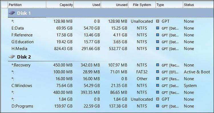

    2. Is the disk layout still look like the screen you posted in the other thread with 2 recovery partitions (450MB and 480MB)?
      How can i boot into advanced recovery options nd-prompt-151353d1504250279t-creators-upgrade-appeared-ok-but-advanced-recovery-functions-fail-1.jpg
      According to suggestions from the thread, you changed from partitiion 5 to partition 1 with reagentc, which in my opinion is not correct. When you upgrade, windows creates an extra 450MB after C: and put a new Winre.wim there and set it to partition 5 (counting from left to right)
    topgundcp, Feb 16, 2023
