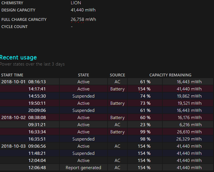

    I have a laptop (Dell Inspiron 3541) with Windows 10. After running powercfg /batteryreport in PowerShell, I got a battery report (at %userprofile%\battery-report.html). However, the results didn't seem right. Here's a screenshot.
    As shown by the battery report, my design capacity is 41,440 mWh, but the full charge capacity is 26,758 mWh (about 65% battery health). However, it also shows that it is charging to design capacity (154%), not full charge capacity.
    Some other weird parts of the battery report:
    My battery has never drained 80% in 40 minutes. 80% in 140 minutes is a much better estimate.
    Over 60 years turned on and on AC in a week? I was running Linux a lot that week, but 60+ years is impossible.
    Is this normal (for a Windows battery report)?
