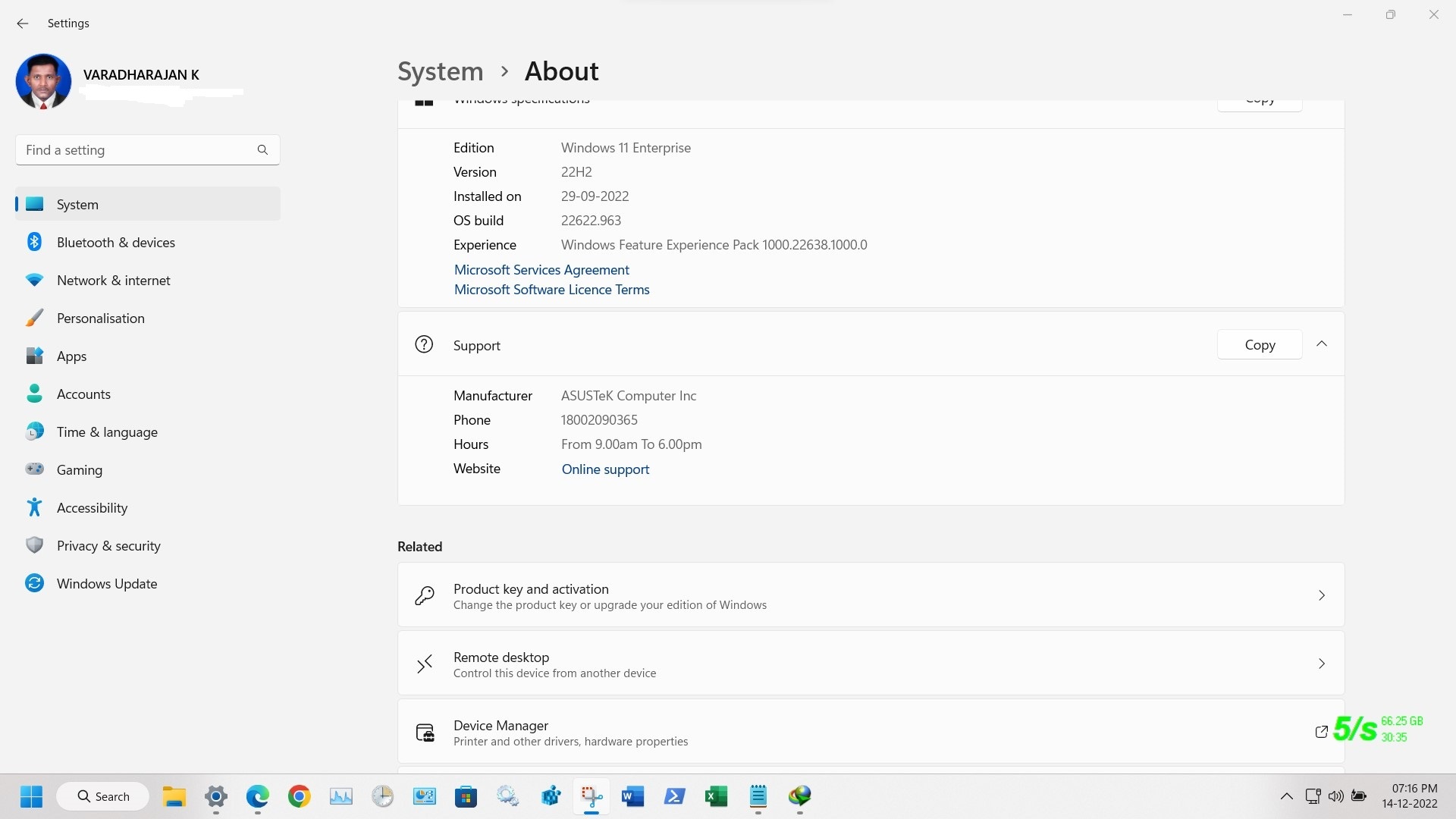

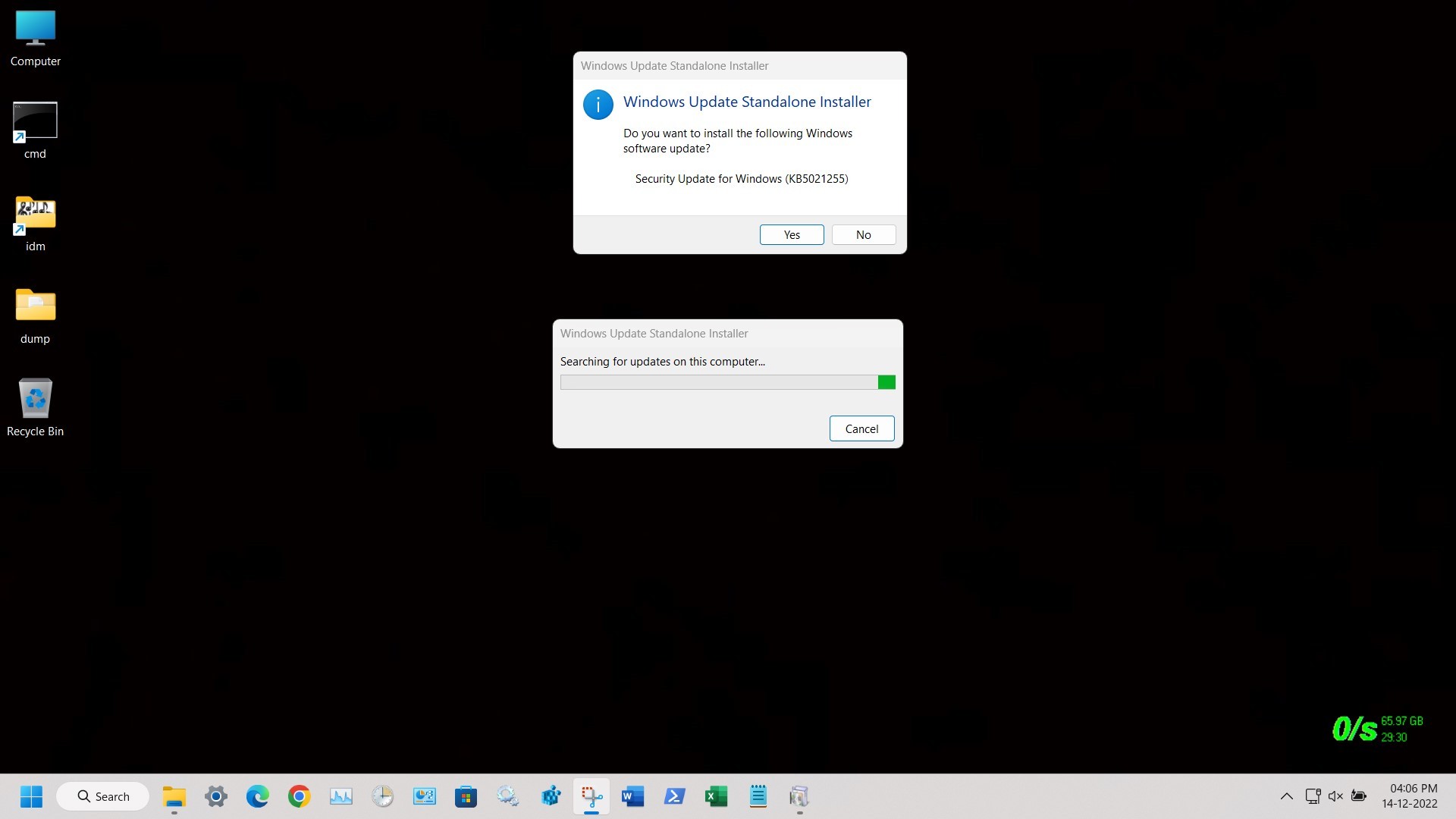

  2. Windows 11 64bit v22H2 build no 22622.963 is successfully upgraded from build no 22622.900 by installing update KB5021255 on 14.12.2022
    On 13th December 2022, Microsoft released another Windows Cumulative Update KB5021255 build no 22621.963 to Windows 11 64bit v22H2.
    On 14th December 2022, I installed this update KB5021255 build no 22621.963 on top of Windows 11 64bit 22H2 build no 22622.900
    I am sharing the direct download links from www.catalog.update.microsoft.com
    For Windows 11 client v22H2 CLU KB5021255 64bit os. Windows users can download it from 64bithere
    How can I install KB5021255 Cumulative Update for Windows 11 v 22H2 RP & Public Build... 28f45a06-d3cb-438a-98e0-0871a0dc7d13?upload=true.jpg
    How can I install KB5021255 Cumulative Update for Windows 11 v 22H2 RP & Public Build... 4607af9b-c096-449e-a54b-3c81d65b9c33?upload=true.jpg
    The source is taken from
    December 13, 2022—KB5021255 (OS Build 22621.963) - Microsoft Support
    If you liked this post and give upvotes to me and share this post with Windows 11 Users
    RAJU.MSC.MATHEMATICS, Dec 20, 2022

    Hi FreddyIzaguirre,
    See if you can install the latest cumulative update using the offline installer (.msu) file.
    2022-12 Cumulative Update for Windows 11 Version 22H2 for x64-based Systems (KB5021255)
    windows11.0-kb5021255-x64_2830fb558a628b0a1847a0025d3da14928f82a5e.msu
    If that doesn't help, please zip the contents of the "c:\windows\logs\cbs\" folder and upload/share it on OneDrive.
