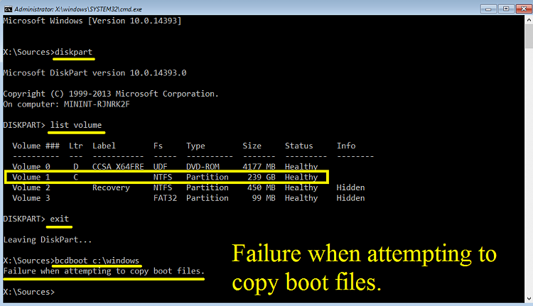

    diskpart
    list volume (note the volume letter where the Windows 10 is installed)
    exit
    bcdboot x:\windows (replace "x" with the volume letter of the Windows 10 partition)
    For example, bcdboot c:\windows or bcdboot d:\windows
    If the volume letter is incorrect, you will receive the following error message: Failure when attempting to copy boot files.
    -OR-
    You need to boot from the Windows installation media in UEFI mode (marked UEFI in the boot menu), if Windows is installed in UEFI mode. If you using the wrong mode, you will receive the following error message: Failure when attempting to copy boot files. (see screenshot below)
