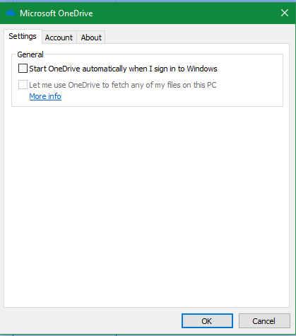

    I found some screenshots that show that I also had to take some action in the System tray [the "Notification area" in Win10-speak] -
    - Step 1 - SysTray, right-click on OneDrive icon, select Settings
    How can I stop my apps saving the data in the onedrive directory? 265507d1580667550t-default-save-directory-word-not-user-turning-off-onedrive-1.png
    - Step 2 - clear the checkbox for starting with Windows
    How can I stop my apps saving the data in the onedrive directory? 265508d1580667574t-default-save-directory-word-not-user-turning-off-onedrive-2.png
    Whilst my written notes do not refer to this action, I must have done it in order to have taken screenshots of doing so. And some of the trimmed-out bits of the screenshots prove that I was in a local account [not an MSAccount] when I did this.
