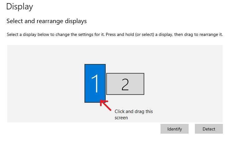

  2. Nikhar_K Win User
    How to align Portrait and Landscape monitor, so that mouse doesn’t jump up or down?
    We understand you want to align multiple monitors in such a way that, the mouse doesn’t jump up or down while moving between them.
    To do this you will have to alignment of the monitor in Settings as per your requirement. Refer the steps mentioned below:
    1. Press Windows key + I, to open
      Settings
    2. Click on System and select
      Display
      from the left pane.
    3. Now, under Rearrange your displays, click on any one of the monitor, hold the mouse button and drag it to align it.
    You can refer the screenshot below:
    How do I align a very large monitor with smaller ones for smooth mouse transition? 5c721934-f7a5-40a2-bedd-942e98a6ecb7?upload=true.png
    However, if you want to move from the bottom of the Portrait monitor to the Landscape monitor, you will have to drag the mouse upwards. Moving the mouse sideways from the bottom will not allow you to move between the monitors.
    We always appreciate our customer’s feedback, and your feedback and suggestions are very important to us. Hence, I suggest you to provide your valuable feedback and ideas in our
    Feedback Hub, where our developers can look
    into the requests and constantly improve the features of Windows.
    Nikhar Khare
    Nikhar_K, Sep 26, 2023
