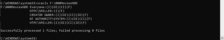

    Here are results from this step:
    How do I delete a symbolic link and how do I make sure I did? 353971d1638814972t-cant-delete-folders-files-within-symbolic-link-junction-mklink-capture01.png

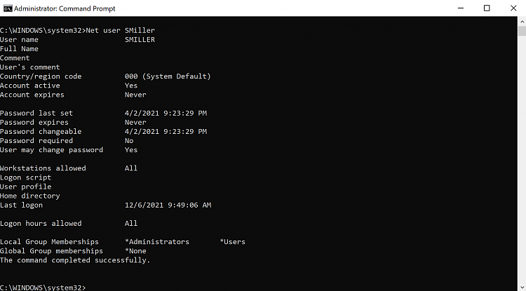

    Local Groups: Administrators, Users
    Results from this step:
    How do I delete a symbolic link and how do I make sure I did? 353972d1638815129t-cant-delete-folders-files-within-symbolic-link-junction-mklink-capture02.png

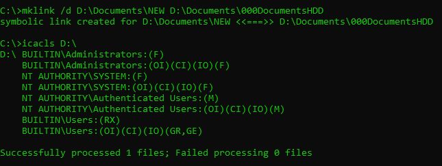

    I don't know what the different notes mean - (I) (OI) (CI) (F) etc Results from the laptop working correctly. For this I created a symlink to my Documents D:\ hard drive
    How do I delete a symbolic link and how do I make sure I did? 353973d1638815219t-cant-delete-folders-files-within-symbolic-link-junction-mklink-capture03.jpg

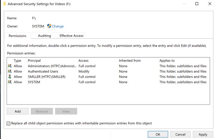

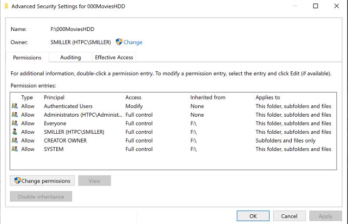

    I had previously taken ownership with my user name "SMILLER" but I added "Authenticated Users" and "Administrators" to the list here:
    How do I delete a symbolic link and how do I make sure I did? 353974d1638815497t-cant-delete-folders-files-within-symbolic-link-junction-mklink-capture04.jpg

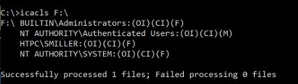

    I also performed this step on the symlink folder F:\Movies that I created where my user name is the Owner and I added Administrators and Authenticated Users, also with no luck.

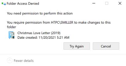

    I also tried this step with no luck. After all of these suggestions I am still getting this error when I try to delete a folder through the symlink:
    How do I delete a symbolic link and how do I make sure I did? 353975d1638815596t-cant-delete-folders-files-within-symbolic-link-junction-mklink-capture05.jpg
    It still says I need permission from SMILLLER
    Thanks for all the suggestions. I would love to get your thoughts on the results above before resorting to a refresh or repair install of Windows. Both of those processes remove installed apps, yes? - - - Updated - - -
    I appreciate your response, as sometimes I may not see the clear answer right in front of my nose. When I click Continue, it still doesn't allow me to delete and says that I need permission from SMILLER, which is my user name:
    How do I delete a symbolic link and how do I make sure I did? 353976d1638815596t-cant-delete-folders-files-within-symbolic-link-junction-mklink-capture05.jpg
    Interestingly, If I go inside the folder and delete the media file itself, it hangs for about 15 seconds and then it deletes. But then I go up one folder level and I still can't delete the containing folder.

    Thank you, You need to restore original security across the whole drive. First Step: Delete all Junction points, Run chkdsc F: /f Sec Step: Give complete Ownership of the drive to SYSTEM. Trird Step: Then reproduce exactly the following for the root of the drive.
    How do I delete a symbolic link and how do I make sure I did? 53980d1638817861t-cant-delete-folders-files-within-symbolic-link-junction-mklink-screenshot00133.jpg
    Apply and replace everything recursively. Try to create a new junction and test it.
