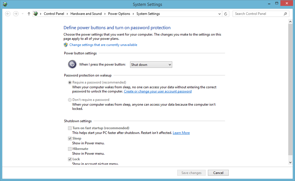

    Disabling Fast Startup
    1. Navigate to Start by either clicking the Start
      icon or hitting the Windows key.
    2. In the Search bar, type Power to bring up various Power Options.
    3. Select Change what the power buttons do.
    4. See the below image:
    If you have UAC enabled (enabled by default unless you disable it manually), before un-checking
    Turn on fast startup, you'll need to select Change settings that are currently unavailable. Once you do that, you will be able to successfully un-check
    Turn on fast startup.
    After you've unchecked Turn on fast startup, your next shut down will this time
    actually shut down the system if you're having the issues described above.
