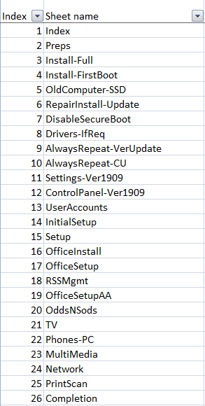

    Art,
    I think he is suggesting keeping a list of non-standard aspects of your setup so that you can 'quickly' whizz through the list if you ever have to set it all up from scratch again.
    I do the same. My setup procedure is in a spreadsheet with one major topic for each sheet.
    How do I easily move my Documents folder to a different drive? 286110d1593630696t-moving-my-documents-folder-others-different-hard-disk-setupindex.png
    Denis
