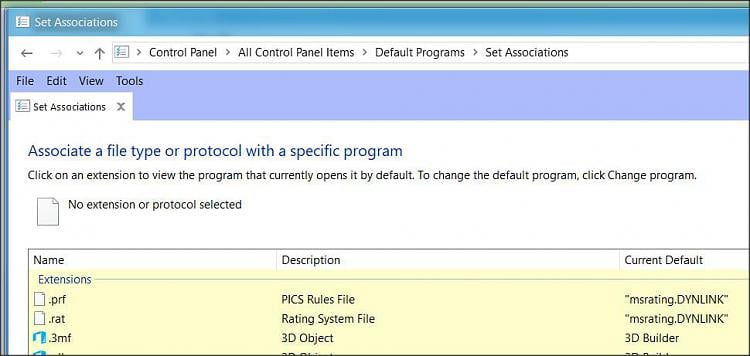

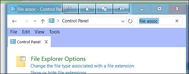

  3. dalchina Win User
    Setting File Associations - Another Step Backwards
    You probably need to go here in the Control Panel:
    How do i fix the problem "This file does not have an app associated with it for performing... 178431d1519487351t-setting-file-associations-another-step-backwards-1.jpg
    - nothing to fix?
    Thus e.g:
    How do i fix the problem "This file does not have an app associated with it for performing... 178432d1519487450t-setting-file-associations-another-step-backwards-1.jpg
    dalchina, Apr 19, 2024
