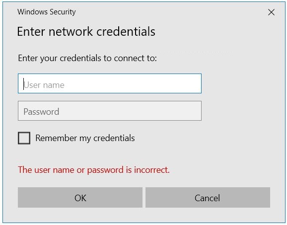

    I tried going to Credential manager and there are a lot of things written under Generic Credentials. I don't know which credentials should I use. I want to know the username and password.I know I can just turn of password protection but I still want to know how to setup what credentials to use and how to change them in case I need to use the password protection in the future.
    Thank you! :

    Sounds like a 'persistence' issue, i.e. A has the credentials to access B 'stored' with the 'persistent' flag set but B doesn't have the credentials to access A stored persistently (or it's corrupted), hence the request.
    Try:
    1. Open Credential Manager (in B's Control Panel, i.e. Start > Search > control > Control Panel > All Control Panel Items > Credential Manager).
    2. Open Windows Credentials (on the right-hand side).
    3. Search for (and remove) any credential for A (in case it's corrupt).
    4. Use Add a Windows credential to add a new network access credential for A (by entering the network address [e.g. computername], Username and Password then click on the OK button.
    If all goes well, when this completes you can open the credential and should see Persistence: Enterprise mentioned underneath the Password field:
