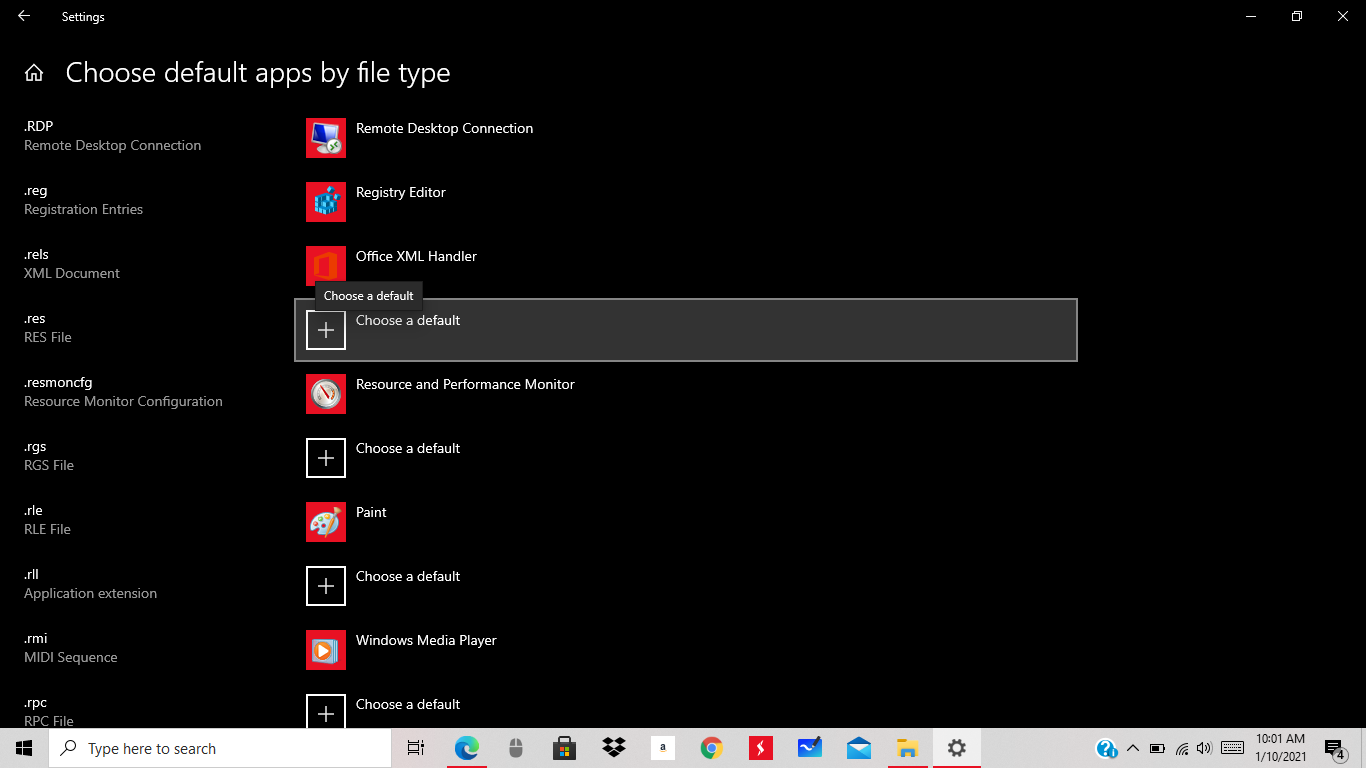

    So I need help on how to change a files type of default app to nothing
    How do I make the files type default app to nothing f33854a9-71c1-4d8f-a345-c869c5c0f400?upload=true.png
    Do you see the "Choose a default" buttons? well I want to change a file type of default app to nothing like that
    btw can you show me a video of it thanks.

    How to change default app for file type
    'Open With > Choose another app' has three step, in the first it only offers apps registered for that file type. If you click 'More apps' it lists all registered apps regardless of suitability. Both these steps have the tick-box for 'Always use...' in my 18363.752. The third step, if needed, is 'Look for another app on this PC'. The 'Always use...' must be ticked before taking this step if you want the change to stick. However, WMP appears at the second step.
    @Bree - yes, I'm quite aware of this thanks, but as you will see it's missing. I recall reading that clicking the dialogue at a certain point in blank space made it appear, and trying that once successfully, but doesn't seem to help now. Plenty of other similar reports of this option being missing.
    How do I make the files type default app to nothing [​IMG]
    'Fix' described here: (essentially unassociate the extension)
    Windows 10 "Always use this app" checkbox missing - Super User
    dalchina, Jan 10, 2021
