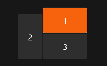

  2. Mouse will not move to or from monitor above main monitor
    I have 3 monitors
    2 stacked on top of each other and one vertical to the side.
    I can move my mouse from the lower monitor, to the side monitor then from the vertical monitor to the upper monitor.
    But, I cannot just move my mouse up to the top monitor.
    Nor can I move my mouse down from the top monitor to the bottom monitor.
    This is how they are set up
    how do I make the mouse appear at the same position when moving it between monitors? jMZD6Z9j3p4mn91Z7NJjEAsu3xCLNHlaOmYTU37VXo7RevB%2fLvpN8rlVtlnq9%2bZpPO70W8qktTrAcbdoW%2bFlw6U%3d.png
    Moving monitor 1 to the side of 3, mouse can move into it from 3.
    But when I move it back to the top I cannot move the mouse directly from 3 to 1 or vice versa.
    Any suggestions would be much appreciated.
    NopeNopedxfgdxcfg, Dec 4, 2024
