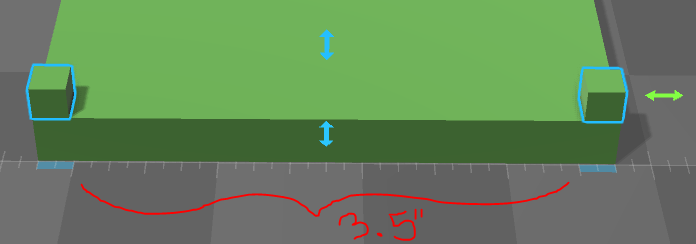

    Next I created the squares you described above. I selected the two squares you are trying to measure the distance between and put them up against one of the rulers on the build platform. From there I can get a rough idea of the distance between the two objects:
    How do I measure an object in Paint 3D? 7a7c8682-c967-4826-ad00-731b964ce316.png
    Notice that the selected objects are also highlighted on the ruler on the build plate and because the units selected are in inches the marks on the ruler are also in inches. Using it we can see that the ruler marks add up to 3.5 inches.
