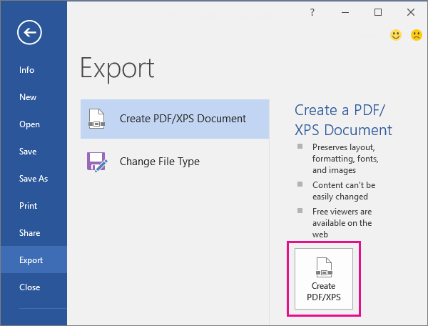

    You can save your Word document as a PDF file by using the following steps.
    1. Choose File > Export > Create PDF/XPS.
    How do I remove author name and other document properties in a pdf document? 0caf5621-6e28-4650-a744-5ecdee1a9181.png

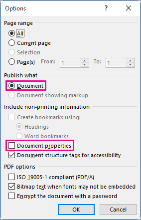

    2. If the properties of your Word document contains information that you do not want included in the PDF, in the
    Publish as PDF or XPS window, choose Options. Then select
    Document and clear Document properties. Set any other options you want and choose
    OK.
    How do I remove author name and other document properties in a pdf document? 5743e9eb-e1d4-4b28-8c99-b101bc4df9f3.png
