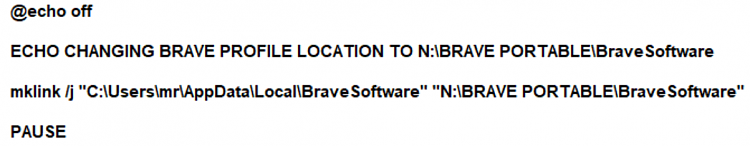

  3. Brave browser move profile location
    This is for a portable version of Brave. I found several sources that offered similar advice, i.e. Is it possible to move Brave'''s profile to another location on the same computer? : brave_browser I created the .bat file
    How do I transfer a specific program, e.g., Brave Browser's user profiles, settings, and... 381574d1671580732t-brave-browser-move-profile-location-brave-bat2.png
    With supposedly a successful result
    How do I transfer a specific program, e.g., Brave Browser's user profiles, settings, and... 381573d1671580640t-brave-browser-move-profile-location-brave-bat.png
    But it does not change the location. All it does is create a fresh profile in the original location, with all data lost, of course, if I don't back it up first. Am I doing something wrong, or is it just not possible?
