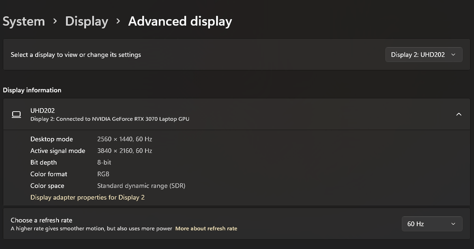

  4. tjr0509 Win User
    How do you change the "Active Signal Mode" on a monitor?
    How to Change Active Signal Mode
    I recently received an Asus 165hz monitor. It is able to display 2560x1440 at 165hz through display port and 2560x1440 at 144hz through HDMI. If I connect my monitor to my laptop directly through HDMI, it will output 2560x1440 at 144hz. I also received a capture card that is able to output content at 240hz at 1080p, 144hz at 1440p, and 60hz at 4k. If I connect my laptop to the capture card and then the capture card to the monitor, it will output 3840x2160 and prevent me from changing the refresh rate to anything higher than 60hz. If I try changing my resolution back to 2560x1440p, the active signal mode will not change. If I try to go to display adapter properties and then select list all modes, there is no resolution for 2560x1440p at 144hz. Please help me figure this out.
    How do you change the "Active Signal Mode" on a monitor? de229733-d144-44b5-aa8b-a79a26f8b616?upload=true.png
    tjr0509, Dec 23, 2023
