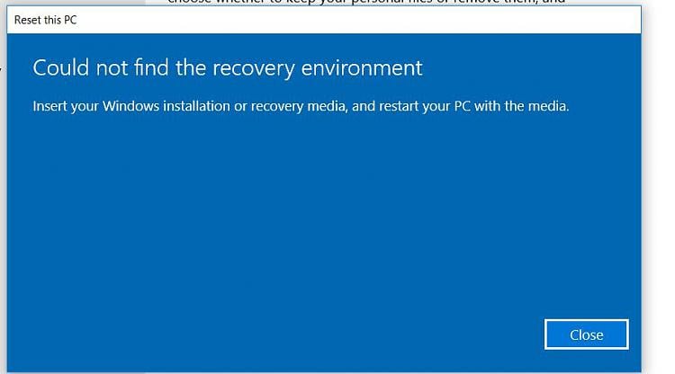

  3. Missing Recovery Environment
    Hi Alan,
    Here is a link containing several useful suggestions to help you recover Windows 10. Since the error message that you got tells you to insert your Windows installation or recovery media. We suggest the perform the steps listed under
    Use a recovery drive to restore or reset your PC or you can also follow the steps under
    Use installation media to restore or reset your PC. Please see the link below for more details:
    Recovery options in Windows 10.

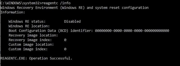

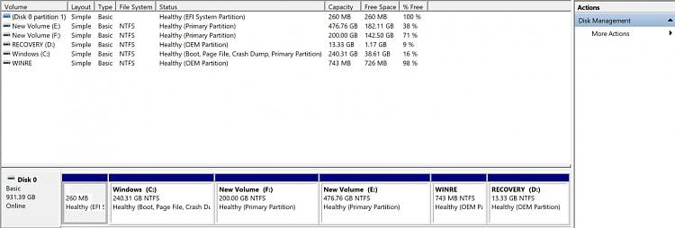

    Can't enable Windows Recovery Environment
    hi
    OS: Windows 10 Pro 64-bit
    Without WinRE I can't repair my system from the hard drive if something happens at boot, or if I need to reset my system.
    This is what happens when I type reagentc /info:
    How do you enable the windows recovery environment? 231194d1555799517t-cant-enable-windows-recovery-environment-2.jpg
    And
    How do you enable the windows recovery environment? 231195d1555799612t-cant-enable-windows-recovery-environment-3.jpg
    It shows that WinRE is disabled.
    Please advice me regarding this issue
