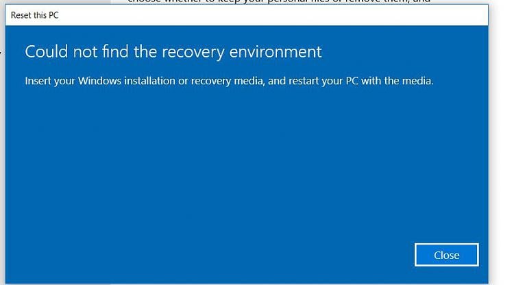

  3. Missing Recovery Environment
    Hi Alan,
    Here is a link containing several useful suggestions to help you recover Windows 10. Since the error message that you got tells you to insert your Windows installation or recovery media. We suggest the perform the steps listed under
    Use a recovery drive to restore or reset your PC or you can also follow the steps under
    Use installation media to restore or reset your PC. Please see the link below for more details:
    Recovery options in Windows 10.

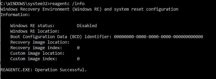

    This is what happens when I type reagentc /info:
    How do you enable the windows recovery environment? 231194d1555799517t-cant-enable-windows-recovery-environment-2.jpg
    And
    How do you enable the windows recovery environment? 231195d1555799612t-cant-enable-windows-recovery-environment-3.jpg
    It shows that WinRE is disabled.

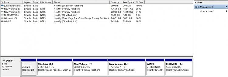

    Please advice me regarding this issue
    How do you enable the windows recovery environment? 231196d1555799743t-cant-enable-windows-recovery-environment-4.jpg
    Regards
