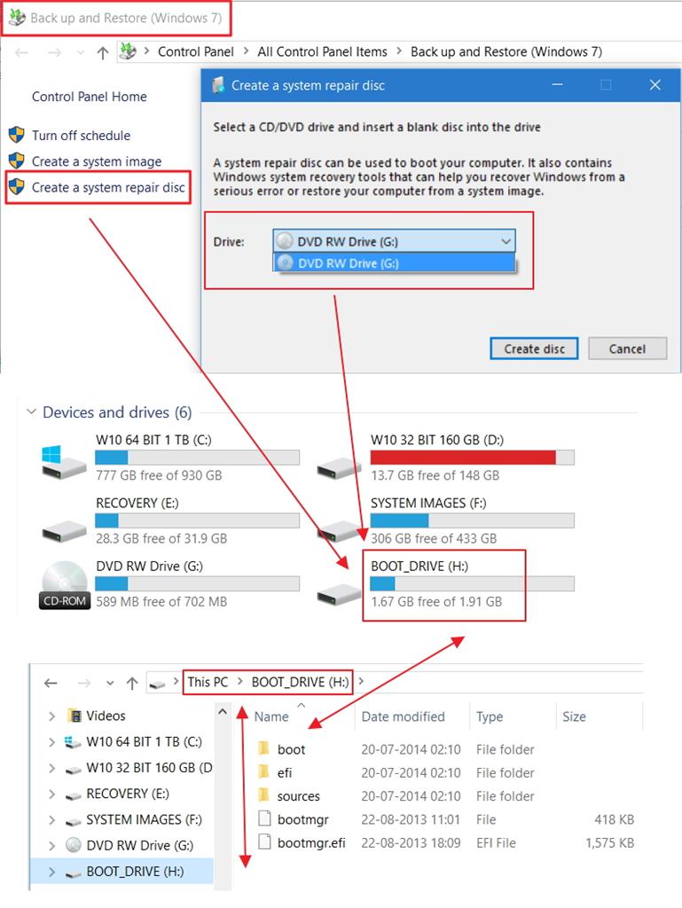

  4. How do you repair windows 10 with reboot able flash drive?
    Windows 10 is not allowing creation of a system repair disk on a flash drive
    • On 64-bit Windows 10 operating system, I wanted to create a
      system repair disk
      using a flash drive [BOOT_DRIVE (HHow do you repair windows 10 with reboot able flash drive? :)] as shown in the image below
    • First question that came to my mind was why the screen title said Back up and Restore (Windows 7) when I was using Windows 10 which was upgraded from Windows 8.1? Windows 7 was no where around. I had seen the same in Control
      Panel before and wondered why?
    • Second question that transpired my mind was why Create a system repair disk does
      not show the flash drive in its drop-down list though the file explorer of windows clearly shows that the flash drive
      is connected to the PC.
      • It is true that Create a system repair disk dialogue box says 'select a CD/DVD drive and insert a blank disk into the drive' but that should
        not prevent creation of system repair disk on a flash drive, particularly when the image reproduced below does show that the flash drive [BOOT_DRIVE (HHow do you repair windows 10 with reboot able flash drive? :)]
        already has boot files on it.
      • A CD has less than 1 GiB capacity, whereas this flash drive has more than 1 GiB free space to accommodate boot files.
      • From any angle we see this situation, it might appear that a flash drive connected to the PC
        should be able to store boot files required for system repair disk creation which would be used for booting the computer, in case something goes wrong.
    I am looking for answers to these questions if someone can help. Thanks.
