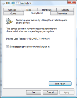

    If your USB key is at least USB 2.0, but is rated slower for the random reads and writes required to use ReadyBoost, more than likely you have seen this message:
    How does the Mounted Devices Key relate USB drives to other keys vistarb1.png
    If so, plug in the USB Key, and cancel Autoplay if it pops up.
    Click on Start button, and select COMPUTER. After Windows Explorer opens, in the right window pane find the USB Key you want to use.
    Right click and select Properties, then select the ReadyBoost tab and uncheck Stop retesting this device when I plug it in.
    Click OK and safely unmount the USB Key from your Computer.

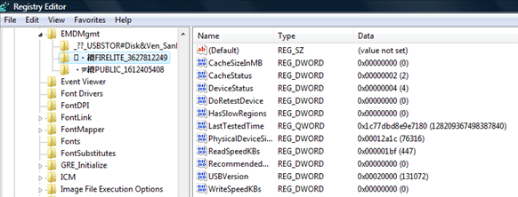

    Before Proceeding - the next step includes exporting the registry key to use as a backup if needed. DO NOT SKIP THIS STEP. As a safe guard, you may want to create a System Restore point when making configuration changes to your System.
    Open the Registry (click on the Start button and type Regedit in the Run field).
    Navigate to:
    HKLM (Local Machine) \ SOFTWARE \ Microsoft \ Windows NT \ CurrentVersion \ EMDgmt.
    Right click on EMDgmt and select Export to back up the Key to a location on your Computer (you may also want to copy to a CD or USB drive that can be accessed if needed).
    How does the Mounted Devices Key relate USB drives to other keys vistarb2.png
    Under EMDMgmt will list all the USB devices that have been connected to your Computer. Select the USB Key you want to use with ReadyBoost and click once on it (in this example I have selected the FIRELITE USB drive).

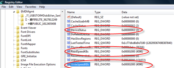

    In the right window pane, modify the following values:
    - Double click on Device Status and change the Value Data to 2 then click OK.
    - Double click on ReadSpeedKBs and change the Value Data to 1000 then click OK. (after clicking OK, the value may be displayed as Decimal - 4096)
    - double click on WriteSpeedKBs and change the Value Data to 1000 then click OK. (after clicking OK, the value may be displayed as Decimal - 4096)
    How does the Mounted Devices Key relate USB drives to other keys vistarb4.png
    Close the Registry when completed.

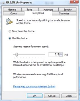

    Plug your USB Key back in to your Computer, cancel Autoplay if it pops up, and go to Start \ COMPUTER and find the USB Key. Right click and select Properties, then select the ReadyBoost tab and you should now be able to use it with ReadyBoost.
    How does the Mounted Devices Key relate USB drives to other keys vistarb9.png
    Keep in mind, ReadyBoost benefit is to only enhance performance for random access reads and is used as a read-ahead cache program.
    Enabling USB Keys that is rated slower than the specification required by ReadyBoost may not give you the performance boost you are looking for. Also if your PC is Dual Core and has 2Gigs or more RAM, you may not notice any performance boost when using ReadyBoost.
    As always test first. Your mileage will vary.
