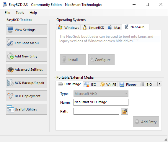

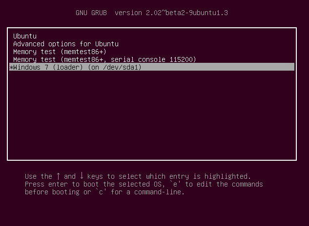

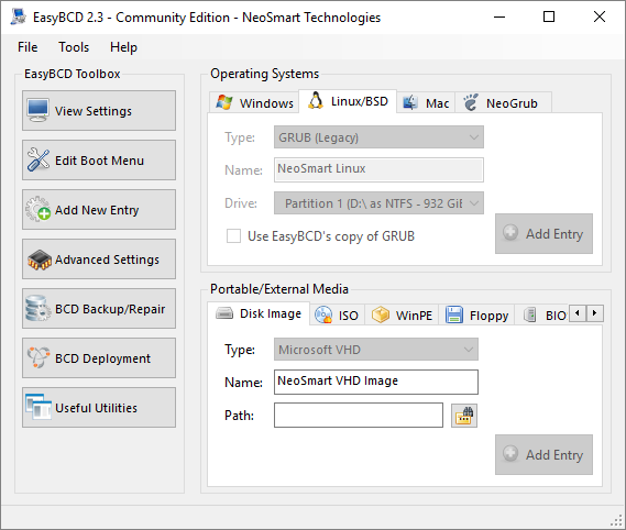

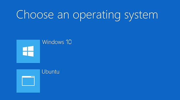

    Hello and thank you for your answer. I disabled the Hibernation as you said (now i don't have the 'Turn on fast startup (Recommended)' inside Power Options), but after a restart, nothing changes, still boots into Windows 10. From what i've read i think the EFI detects another bootloader at startup and deletes it (Linux's grub2), because normally, after Ubuntu's installation it should boot directly into grub2 bootloader (i attached a picture). I'm using EasyBCD usually to repair the Windows Metro bootloader (picture attached - it should look just like the screenshot) to chose from it which OS i want to use.
