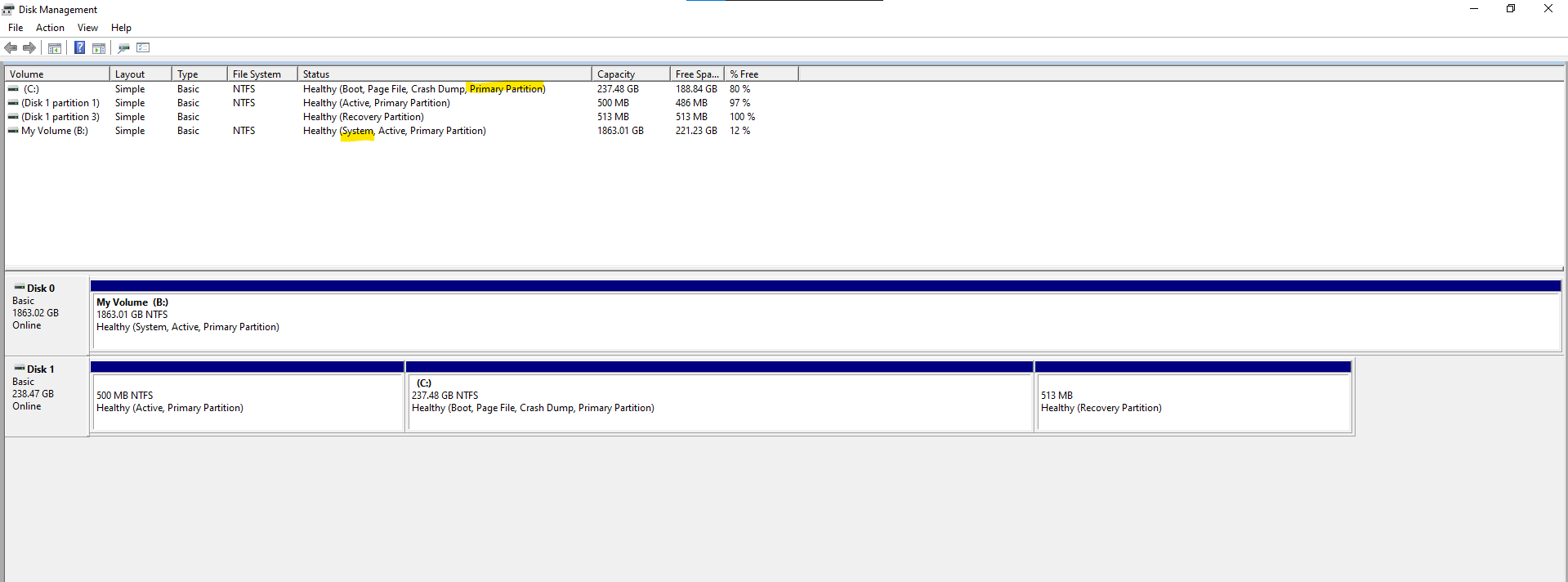

    How to change driver status or type from system to primary partition
    How to change driver status or type from system to primary partition 53554fed-9163-46b5-8a12-c91fe0683182?upload=true.png How to change driver status or type from system to primary partition?
    also when i setup windows i show ssd C: last drive and primary , and my hdd drive first system type

  2. W1zzard Win User
    W7 Hard drive partition issue
    to get rid of that 100 meg windows partition that setup creates for you on a new install on a blank hdd:
    - press shift+f10 when on the partition management screen in setup <-- this opens a command prompt
    - diskpart <-- start the windows command line partition management tool
    - list disk <--- list the installed hdds in this computer for the next step
    - select disk 0 <- might have to replace 0 with the number of the correct disk
    - clean <-- this will erase all data on the disk you selected one step up- dont use the wrong disk!
    - create partition primary <- creates a primary partition taking up all space on the drive, adjust the command if necessary
    - exit, exit to exit diskpart and the command prompt
    - click refresh in partition manager and select your newly created partition and install to that

  4. lx07 Win User
    Modify windows 10 partitions?
    edited diskpart output from first post: Code:
    It is OK to have boot partition as logical but not system (as system must be active primary partition) I believe.
