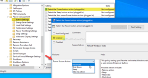

  4. Nikhar_K Win User
    How to change Power button action when on battery or plugged in
    Use the power button to turn off the computer at Welcome screen
    I understand that you want to turn off computer at the Welcome screen using the power button.
    Ideally, if no user has logged in to the computer, the computer will shut down by pressing the power button. However, I would suggest you to check the settings for power button. Refer the steps mentioned below and see if that helps:
    1. Press Windows key + X, and select
      Power Options.
    2. Click on Additional power settings.
    3. Now, click on Choose what power button does from the left pane.
    4. Click on Change settings that are currently unavailable.
    5. Select Shut down from the drop down for
      When I press the power button.
    If you are using Windows 10 Pro, you may also want to check the Group Policy Settings, refer the steps mentioned below:
    1. Press Windows key + R, to open
      Run
      dialog box.
    2. Type gpedit.msc and click on
      OK
    3. Navigate to Computer Configuration\Administrative Templates\System\Power Management\Button Settings.
    4. On the right pane, double click on Select the Power button action (plugged in), click on
      Enabled and select Shutdown from the drop down for
      Power Button Action.
    5. Repeat step 4 for Select the Power button action (on battery).
    6. Restart the computer.
    If a user has logged in to the computer and then logs off from the computer, the computer will shut down by pressing the power button. However, if a user is logged in to the computer and locks the computer using the
    Windows key + L combination, the power button will not shutdown the computer. You will have to use the power button on the lock screen to shut down the computer.
    If you do not see the shutdown button, please refer the article Shutdown:
    Allow system to be shut down without having to log on
    If the issue persists, I would suggest you to provide a feedback in the
    Feedback Hub. The Feedback hub lets you tell Microsoft
    about any problems you run in to while using Windows 10 and send suggestions to help us improve your Windows experience.
    Nikhar Khare
    Nikhar_K, Nov 29, 2020
