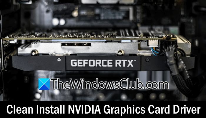

    How to clean install NVIDIA graphics driver in Windows 11
    How to clean install NVIDIA graphics driver in Windows 11 clean-install-NVIDIA-graphics-driver.png
    Sometimes, we encounter display issues on a Windows computer. Most of the time, display issues are associated with a corrupt graphics card driver. In such cases, updating the GPU driver restores normal display functionality. However, in some cases, we need to perform a clean installation of the display driver. In this article, I will show […]
    This article How to clean install NVIDIA graphics driver in Windows 11 first appeared on TheWindowsClub.com.
