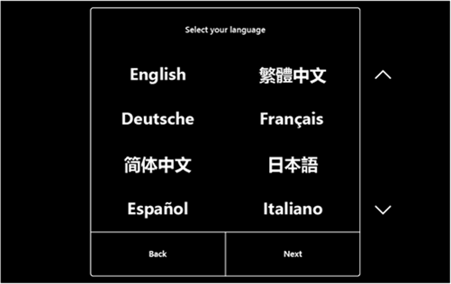

      HoloLens 2 will walk you through the following steps:
      1. Select your language.

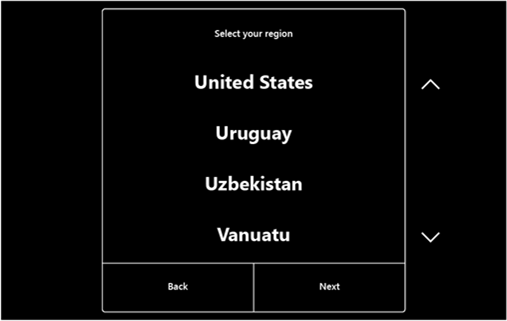

      1. Select your region.
      How to connect to hololens via Wifi ? %2fZuw2Rs7p6qIXXmrop1z0FjBqXzq%2fBVNoGjkLREJFqQ8zrkzmwXMX%2fxU6Lbsa3Yk3jJBNZs7wMaQNJx%2f3dBnA%3d.png

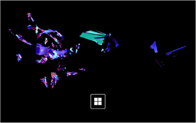

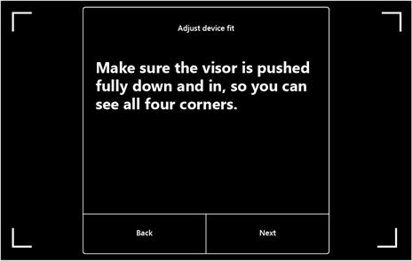

      1. Calibrate HoloLens to your eyes.
      To calibrate, you'll look at a set of targets (referred to as gems).
      How to connect to hololens via Wifi ? vdRkHNI5gkt6wV2suQ5G1CVFZneytk0%2blYuKFcd9jyFkwZQhLF92xtkzduD638ilhPRDa62Jbdic2QB85l7ZPZuct7c%3d.png

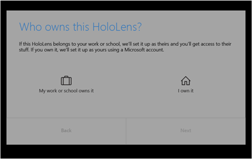

      1. Connect to the internet (select Wi-Fi or your ethernet connection).
      1. Sign in to your HoloLens and select “My work or school owns it”
        1. Enter your Organization Email address (*** Email address is removed for privacy ***)
        2. Sign into Okta with your normal credentials
        3. Accept the privacy statement and the end user license agreement.
      How to connect to hololens via Wifi ? ReUPerw7yC4iffZXkpNCICZPoTrGqmZ9fdXlE2On6SASIuIIbtkns766w6%2fyUwpe6p4AdrCmJvB5TE%2fFUmbDyDRas%3d.png

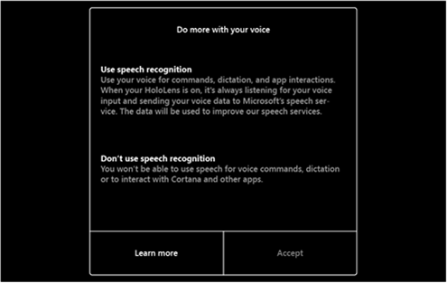

      1. Select “Don’t use speech recognition”
      How to connect to hololens via Wifi ? F0XcrvrjsTmlV%2fRpiJl9rOL9rC4VKDVsLducrCdSWznx5qvtdEIQmD61%2bqO%2f8kITPRMD%2bN3Ok%2fy3DFcwGoQ%3d.png

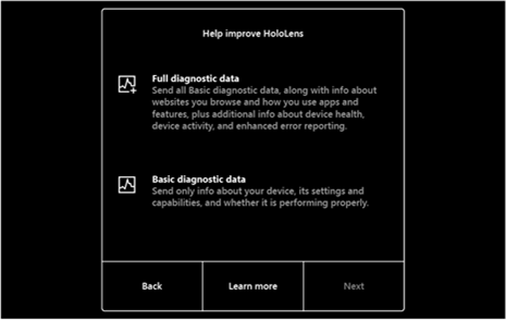

      1. Select “Basic diagnostic data”.
      How to connect to hololens via Wifi ? 2fwOwv4nm%2bploWVyNb58n5aiPcsunCXZmaWs2TOhOHWcMjVPgCbibXU%2bCsyUyxok%2fZ9Nfgyf7UVupQRo7REAA5M%3d.png

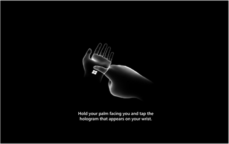

      1. Learn how to use the Start gesture on HoloLens 2.
      How to connect to hololens via Wifi ? ECtTfvpA2an8U3YiQnGYsDHQNwkcxD6DZf3nc4QCM%2fg2n%2bHgqi%2bXUqbipyq7nwr61J3qFLuaqAcdM%2bWFnErLw%3d.png

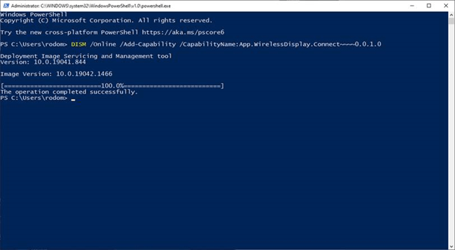

      To present HoloLens via WebEx, you need the “Connect” app. Open PowerShell Admin and paste:
      DISM /Online /Add-Capability /CapabilityName:App.WirelessDisplay.Connect~~~~0.0.1.0 and press Enter. After some time the operation should complete and the app will show in the start menu. Close the PowerShell box when done.

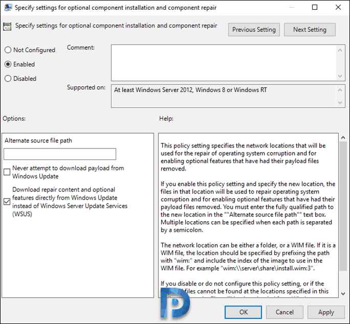

      NOTE: Fix for installation error 0x800f0954

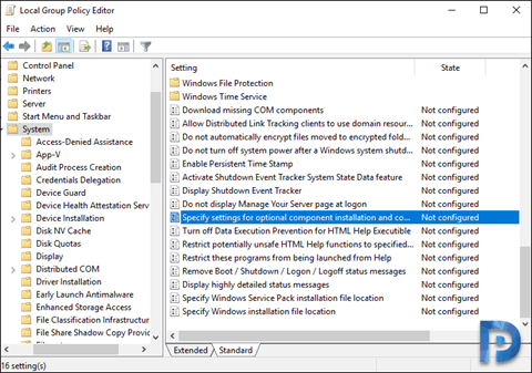

      • On your Windows computer, right click Start and click Run.
      • Now type gpedit.msc and hit enter.
      • In the local group policy editor, navigate to Computer Configuration\Administrative Templates\System.
      • On the right pane look for policy named “Specify settings for optional component installation and component repair“.
      How to connect to hololens via Wifi ? FSasPSZ6m%2fcaYjYK4pmKjal6T9Sca%2bHBGSyVaAnXQcK2k1YgFXKt%2fNQe4WAjJltd%2fuOVW9mkPj3E2YeoUyBP4%3d.png
      Right click policy setting and click Enabled. In addition to that, check the box “Download repair content and optional features directly from Windows Updates instead of Windows Server Updates Services (WSUS)“.
      How to connect to hololens via Wifi ? X9iidN%2bKF3wyjS9OWtLFBG8XqgYbrNSAPON1cmGT96RxXW3B7obJc7cUItSRrWycfIcquOvikYfcwsf02v2gM1FUIFk%3d.png
      Download repair content and optional features directly from Windows Updates instead of WSUS
      Click Apply and OK. Now open the command prompt on your computer and run the command gpupdate so that the latest policy settings are applied to the local machine.

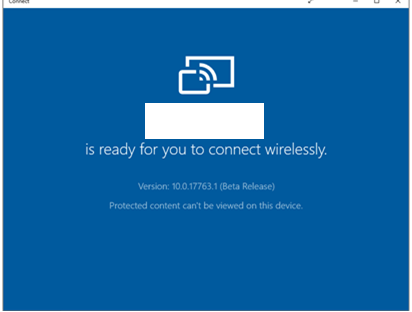

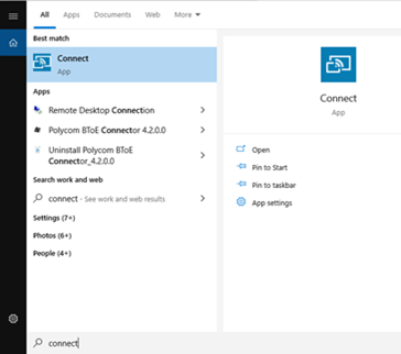

      1. Open the “Connect” app on your computer
      How to connect to hololens via Wifi ? ff8cAIbSYwcbpA3uQRctRmjtxssvQUV55Zxaz8TxU8kWYauHj5oCyrl2pc4FjyezW65ZUbCtvVNLHLVVvfnYkHFhcBO8s%3d.png
      How to connect to hololens via Wifi ? iFjetLOkpXalYDvYex8GLJdmyW4M35PBgYC%2fQAI%2fD4gY45gZ9dkU9TjFgq6Ew8zDpcfKGax%2fg2mC4pnxBsO8IfM%3d.png

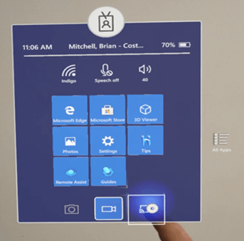

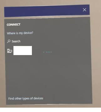

      1. On your HoloLens select the “Miracast” icon from the Start Menu
      How to connect to hololens via Wifi ? y2IFuSvwfi67y3xjhHUGT8j9hFpnEdIS9ITVtE9QcYS8JgI8Ik048V2EDicdnvahGtBWPERJHEDEuXKinESrk6QS%2fFs%3d.png
      How to connect to hololens via Wifi ? csy277vPIUjLpCv7VIY6pP2OUFZz6SoCpXMPnUAy5CYmOyf4uENLG2G%2bCw5vI4fSATlJgFjSejOjU%2fRJZH%2fDNBM%3d.png
      Select your computer

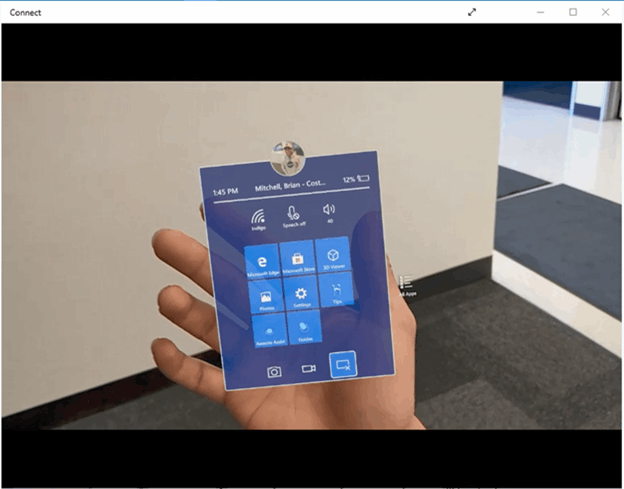

      1. After a couple moments your HoloLens will be sharing onto your computer through the “Connect” application.
    How to connect to hololens via Wifi ? Fo1qg5DFNby808n1Y4fYsz2riiqb30bjC31WneBsO3LcxVfSgKm9aFiJZue2USS92OJefZGYZizKqdxTOuCbnoIaTZG3o%3d.png
