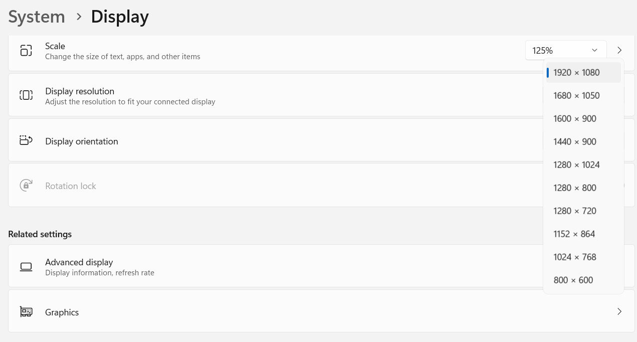

    I am attempting to connect my laptop (Dell Inspiron) to a dual monitor arrangement (one 1920x1080, and an ultrawide 3440x1440). When either single monitor is connected, the display resolution is correct and everything works well. However when connecting the second monitor, the resolution of the ultrawide reduces to 1920x1080, with no option to increase this. 3440x1440 is also not displayed in the 'list of valid modes' accessed under advanced display--> display adapter properties --> List all modes.
    how to correct my display being too big for my monitor - a7e9f080-c336-44e5-96ae-4699efd62d8f?upload=true.png
    I have checked graphics, and display adapter drivers and confirmed that the most up-to-date is installed. I have performed multiple system restarts, but I'm confused why the problem only occurs when a second monitor is connected. The correct 3440x1440 resolution option is available and works well when the ultrawide is the only monitor in use.
