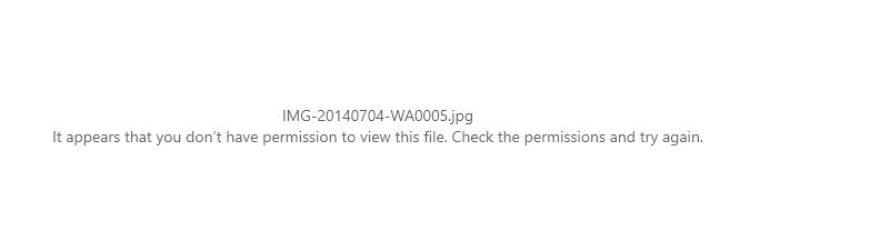

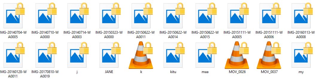

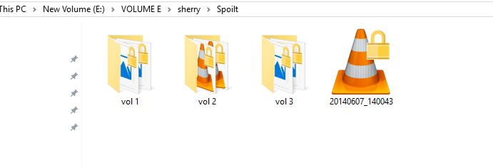

    Hi, My name is Gregory. I encrypted my files using the advanced attributes - encrypt content to secure data, while I was using windows 7. I later formatted my PC and installed windows 10 before decrypting my files. I don't have the 'certificate' to decrypt the files? what can I do since all the enyypted files and folders have 'lock' as shown below:-
    How to decrypt files that were previously encrypted on windows 7. Misplaced the 'certificate' 9c0d6724-a181-46ea-98ae-903dc82fa5cc?upload=true.jpg
    How to decrypt files that were previously encrypted on windows 7. Misplaced the 'certificate' 919ba2c6-0b4d-4398-8378-9f0704a38f21?upload=true.jpg when I open e,g an image i get this error message,
    How to decrypt files that were previously encrypted on windows 7. Misplaced the 'certificate' a8047289-1b84-4934-8525-83ffbf4f99d7?upload=true.jpg
    kindly assist.

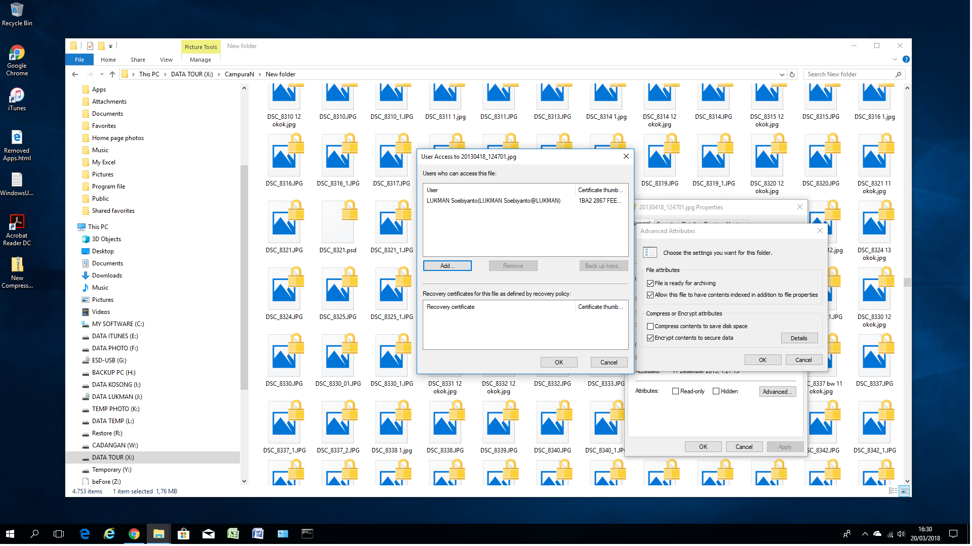

    i cannot decrypt previously encrypted files maybe a certificate deleted. I can see the user name and a certificate thumbprint but can not be backed up key (Encrypting Fiel System: to add user this file, you must have access to the file and write or modify
    permissions for it)
    How to decrypt files that were previously encrypted on windows 7. Misplaced the 'certificate' 6562a8f7-f520-46e4-822e-fa05b247ccac?upload=true.png
    LUKMAN Soebiyanto (live.com, Feb 7, 2020
