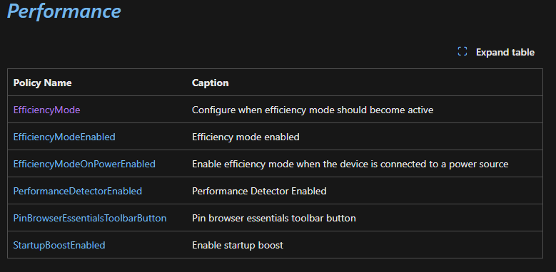

    Windows does not have a switch to toggle Efficiency Mode.
    For browsers, the following link describes the policies and registry keys associated with efficiency mode.
    [table][tr]Disclaimer: Generally, modifying registry subkeys or work group is intended for advanced users, administrators, and IT Professionals. It can help fix some problems, however, serious problems might occur if you modify the registry incorrectly. Therefore, make sure that you follow these steps carefully. For further protection, back up the registry before you modify it. Then, you can restore the registry if a problem occurs. For more information about how to back up and restore the registry, click How to back up and restore the registry in Windows - Microsoft Support to view the article. [/tr][/table]
    In some cases, the graphics driver may be one of the triggers for the problem.
    Some community members use special commands to limit the efficiency mode of some programs (posted in October, information may be time-sensitive.).
