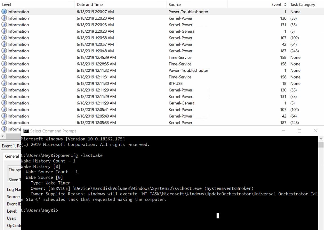

    The laptop is brand new and upgraded to May 2019 latest build.
    You can see from title and the attached image that the pc wakes up from standby and it seems related to a system event (usoclient.exe), from task scheduler.
    I can't disable them manually as it requires a password assciated to system account, I think, but have no idea what made those tasks, scheduled to run two times a day, but even more annoyingly the pc resumes much more often than that.
    Are they related to windows (update), perhaps?
    There are no pending updates for sure. Have no idea what to blame for...
    how to disable system task waking up the pc repeatedly? 57e508e0-d13e-4fd5-8987-032240fc13f7?upload=true.jpg
    riccardo.l, Jun 19, 2019
  2. how to disable system task waking up the pc repeatedly?
    Thank you for your response along with the screenshot.
    We looked into this and want to suggest you to disable/uncheck Wake the computer to run this task in Hidden administrator account.
    Steps to enable hidden administrator account on your PC.
    1. Click on start menu and type CMD, right click and select Run as administrator.
    2. Copy and paste this command: Net user administrator /active:yes
      and hit Enter key.
    3. Close the command prompt and sign out from the current user account.
    4. Login to the hidden admin account and then uncheck
      Wake the computer to run this task option.
    5. Login back to the original user account and put the PC in sleep and check.
    6. If the issue is fixed then open command prompt in admin.
    7. Copy and paste this command: Net user administrator /active:no
      and hit Enter key to disable the hidden admin account.
    However, if you still unable to disable it then locate and the delete the
    Universal Orchestrator task from this location C:/Windows/System32/Tasks/Microsoft/Windows/UpdateOrchestrator
    and check if you still face the issue.
    We await your response.

  4. how to disable system task waking up the pc repeatedly?
    Thank you for your follow up, as I said I can't modify tasks on my account, reason why I can't disable the "Wake the computer to run this task" either.
    Upon enabling the hidden admin account and deleting the Update Orchestrator task it turns out that the "UpdateOrchestrator Idle Start" Task gives the same problem, so I deleted both. However as soon as I come back on my account they are both regenerated
    and scheduled to run right away, that is they''ll wake up the PC as soon as I standby.
    I don't find anything to add but that it is as nasty as unbearable issue.
    riccardo.l, Jun 26, 2019
