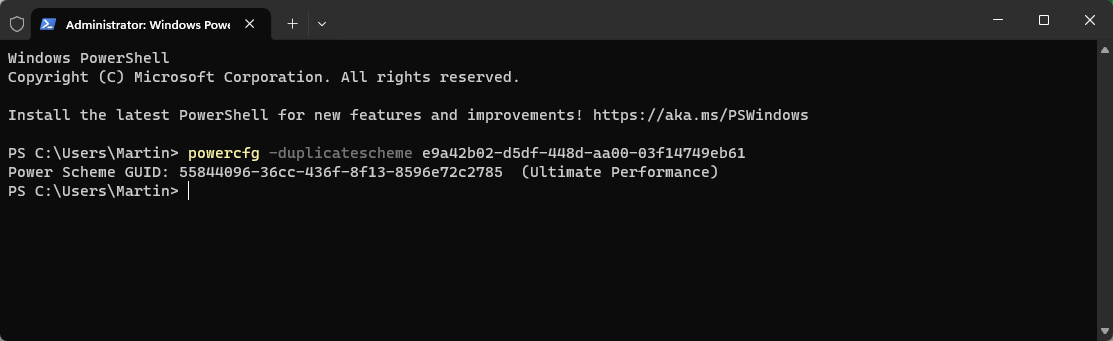

    It takes just a few steps to add the Ultimate Performance power plan to the Windows 11 system.
    1. Use the keyboard shortcut Windows-X to open the secret menu.
    2. Launch Terminal from the menu.
    3. Type the command powercfg -duplicatescheme e9a42b02-d5df-448d-aa00-03f14749eb61.
    4. Press the Enter-key.

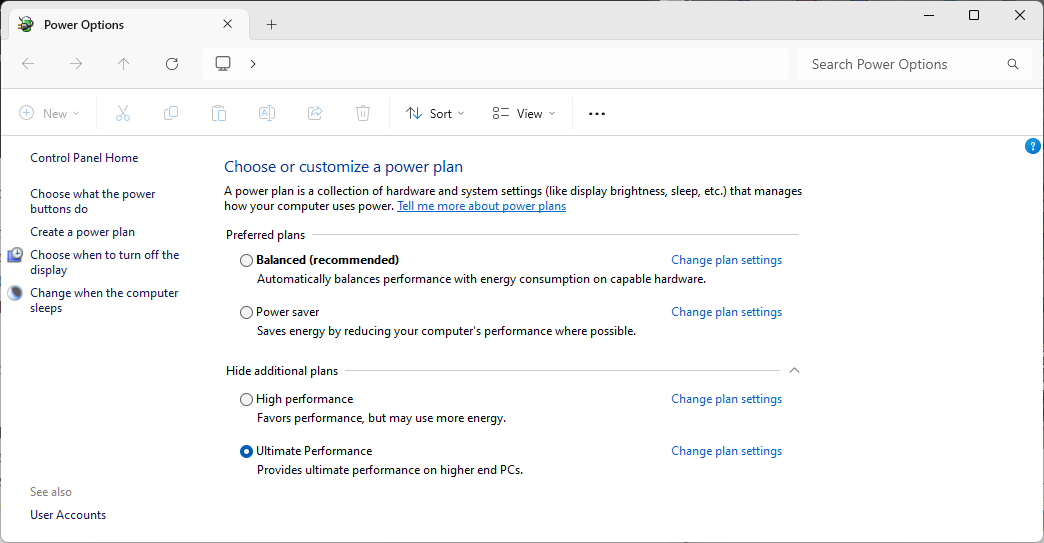

    This adds the power plan to the operating system. A restart of the system is not required. It can now be selected in the following way:
    How to enable the Ultimate Performance plan in Windows 11 windows-11-power-options.png
    1. Open the Start menu.
    2. Type Power.
    3. Launch Power options.
    4. Select Ultimate Performance in the window that opens. (you may need to expand "hide additional plans" to see it)
    Note that you may change the power plan at any time. Just select a different plan, the recommended Balanced plan for instance using the Power options menu.
