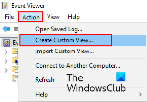

    1] Type “Event Viewer” in the Windows 10 search box and click on the app to launch it.
    2] To view the BSOD error logs, you have to create a filter. For this, go to “Action > Create Custom View.”
    How to find and view BSOD log files in Windows 10 Event Viewer find-BSOD-log-files-WIndows-10_1.png

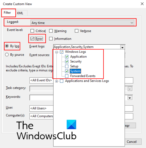

    3] In the Create Custom View window, make sure that you are under the “Filter” tab. Select the time when you have observed the Blue Screen of Death error on your system in the “Logged” drop-down menu. If you know the exact date and time of the BSOD error, you can select the Custom range option.
    In my case, I did not know the date and time of the error. That’s why, I left the setting to default, “Any time.”
    4] Now, select the checkbox “Error” in the Event level section and select the “By log” radio button. After that, click on the Event logs drop-down menu and expand the “Windows Logs” section. Here, you have to select the following checkboxes:
    • Application
    • Security
    • System
    When you are done, click OK.

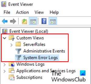

    5] After that, a new window will open where you have to enter the name of the filter you created and click OK to save it.
    I saved it with the name System Error Logs. You can view it in the “Custom Views” section on the left panel.
    How to find and view BSOD log files in Windows 10 Event Viewer find-BSOD-log-files-WIndows-10_3.png

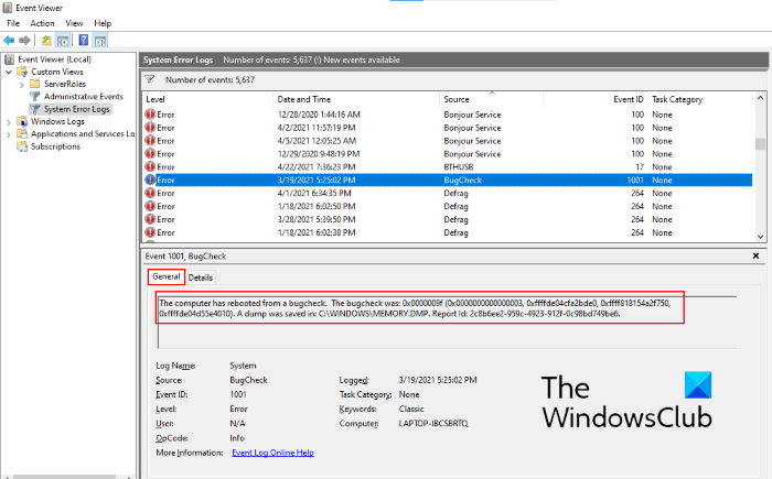

    6] After selecting the filter you have just created, you can view all the system error logs in the middle panel of the Event Viewer. To view the BSOD log, you have to find the error with the source “BugCheck.”
    Now, click on the “Source” to arrange all the entries under it alphabetically. This will make it easier for you to locate the BugCheck entry.
    How to find and view BSOD log files in Windows 10 Event Viewer find-BSOD-log-files-WIndows-10_4.png
    Under the “General” tab, you can view the error code. Click the “Details” tab to know more about the error.
    The message, “The computer has rebooted from a BugCheck” in the General tab indicates that this is a BSOD error.
    Now you can easily find BSOD errors and troubleshoot them.
