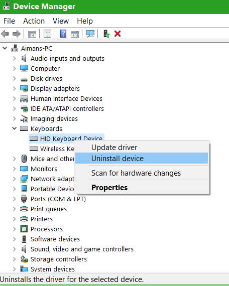

    You're welcome. I guess.. try that same method: 1) Unplug your Keyboard Wire from the Tower 2) Press, and hold down, that Shift button 3) While holding down the Shift button, with your other hand, plug the Wire back into the Tower, and let go of Shift afterwards. 4) Press Shift Hopefully it got fixed? If not, my suggestion is: 1) Search for, and open, Device Manager 2) In the Keyboards section, right click and uninstall every entry there. In my example, there's 2. (If asked to delete all driver files, say yes)
    How to fix computer with seems like shift automatically pressed even without keyboard pluged 388419d1680451911t-shift-button-shutting-down-computer-image.png
    3) Unplug your Keyboard from the Tower 4) Plug it back in. Wait a few moments for Windows to reinstall the drivers... 5) Open an internet window and try typing stuff to see if the keyboard is all set up. 6) When typing letters works, Press Shift
