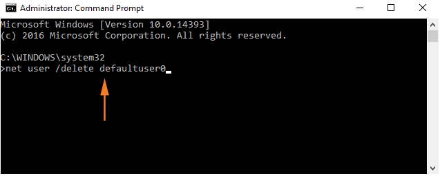

    If the defaultuser0 is not listed on the box. We’re going to use the command prompt to do it.
    • Type cmd on the Cortana/Search bar. Right click on
      Command prompt and click Run as administrator.
    • Click Yes on the pop up of User Account Control.
    • Type net user /deleteuser0 and hit
      Enter.
    How to fix defaultuser0 being administrator 0dd1466f-ae1a-4469-b06f-cc9a17fc5651?upload=true.png
    After deleting the defaultuser0, please try to back up again.
    We’ll keep an eye for your response.

    Delete the user with net user defaultuser0 /delete
