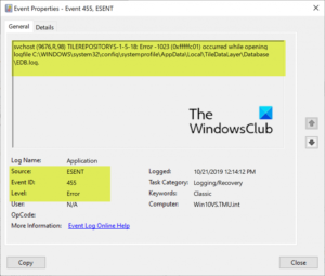

Discus and support How to fix Event ID 455 ESENT error on Windows 10 in Windows 10 News to solve the problem; [ATTACH]ESENT is a built-in database search engine on your PC which helps File Explorer, Windows Search to search for parameters throughout your... Discussion in 'Windows 10 News' started by WinClub, Jul 19, 2020.

  4. How to fix Event ID 455 ESENT error on Windows 10
    Event ID 455
    Hi NancyK1104,
    We understand your concern as you are getting an event ID 455 with Error -1023 (0xfffffc01). We would like to know the Windows 10 version and Build installed? (Type
    winver in Windows search/Run command) Also if you can let us know what are the troubleshooting steps performed on the PC.
    Meanwhile, we would like you to perform these methods and check.
    Method 1:
    1. Press Windows + R key and launch
      Run
      command.
    2. Copy and paste this path: C:\Windows\system32\config\systemprofile\AppData\Local\
    3. Click on Ok and then create a folder and name it
      TileDataLayer.
    4. Open it then create another folder and name it
      Database
    5. Restart the PC and check.
    Method 2:
    1. Click on Start Menu and type CMD, right click on
      CMD icon and select Run as administrator.
    2. In the Command Prompt window type the following command and press
      Enter after each command
    • cd config\systemprofile\AppData\Local
    • mkdir TileDataLayer
    • cd TileDataLayer
    • mkdir Database
    3. Restart the PC and check
    Method 3:
    We would also suggest you to create a local user account with Administrator privilege on the PC and check if you are able to access the TileDataLayer folder. Refer this article to
    Create a local user or administrator account in
    Windows 10
    Let us know how it goes.
