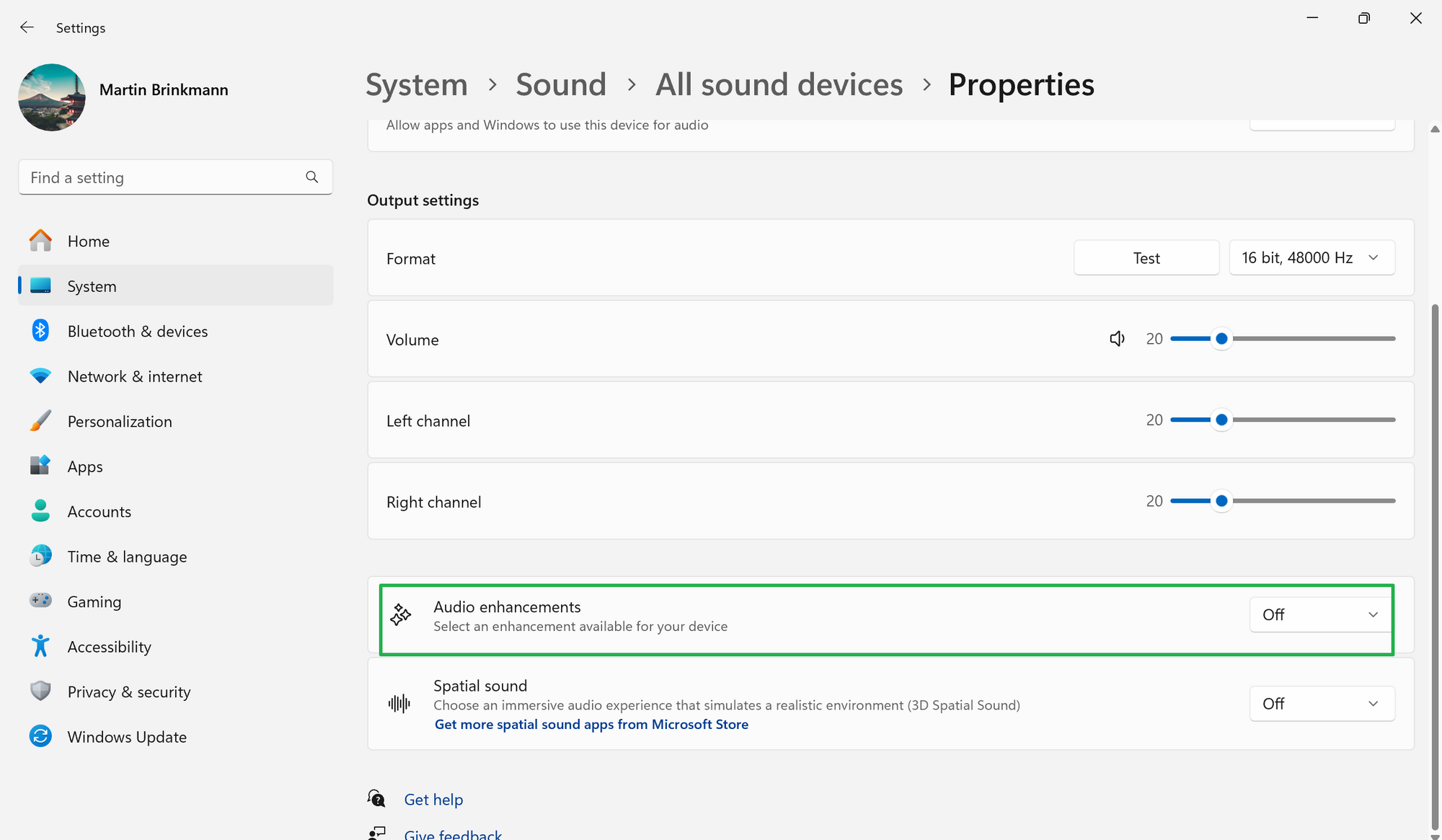

    How I fixed the low volume in Windows 11
    How to fix low audio volume on Windows 11 devices fix-low-audio-volume-windows-11.png
    1. Left-click on the Volume-icon displayed on the Windows taskbar.
    2. Activate "Select a sound output".
    3. Click on "Move volume settings". This opens the Audio settings.
    4. Scroll down to the Advanced section and select "All audio devices".
    5. Select the audio device under Output that you use to play audio on the Windows 11 PC.
    6. Turn the feature Audio Enhancements to Off on the page.
    This fixed the issue immediately on my end. It is probably a good idea to turn the volume down before you make the change, as you may get blasted if you turned everything up to max.
    I do not know what caused this. I did not enable the audio enhancements feature manually and did not install a new driver or an update of any kind between the time audio worked normally to when I experienced the issue for the first time.
    Still, if you experience a low audio volume on Windows 11, preferably without you having made any changes, there is a good chance that the above fix may resolve the issue on your end as well.
