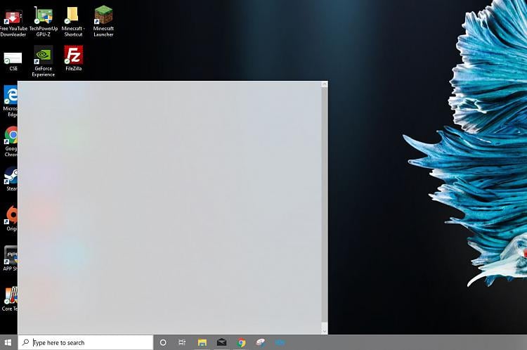

  4. drew1942 Win User
    How to fix my broken search bar? I've tried every method
    my search bar is broken
    ive tried as many fixes as i could, mainly the ones shown in video, but nothing is working.
    i just set up my new oculus rift s and was testing it out by trying to get minecraft vr working, but every time i launch the game it says "windows automatic updates must be enabled" ... so i enabled the updates, windows did some small updates (now on version 1909, build 18363.628), i restarted the pc, and now minecraft vr still wont work (same error) and all i got out of my troubles is my search bar no longer works. please let me know what else i can do to fix this.
    How to fix my broken search bar? I've tried every method 265837d1580908966t-my-search-bar-broken-search-bar.jpg
    drew1942, Jul 17, 2024
