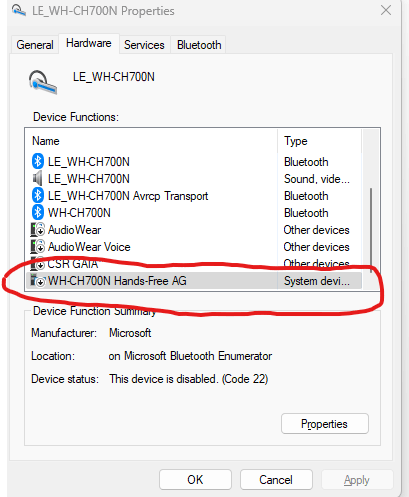

    The solution I found was to disable the hands free driver for the device:
    Using the device property page found from "Control panel" -> "Hardware and sound" -> "Devices and printers" go to the hardware page and disable the hands free system device.
    How to fix Windows 11 Bluetooth Microphone Not Working When Hands Free Telephony is Disabled? 81b2f694-9f5f-4699-ae61-f7d432f2ddaa?upload=true.png
    After this process, even though hands free telephony turns back on, it is unable to select the hands free device and the headphones stay in audio mode, rather than headset mode.

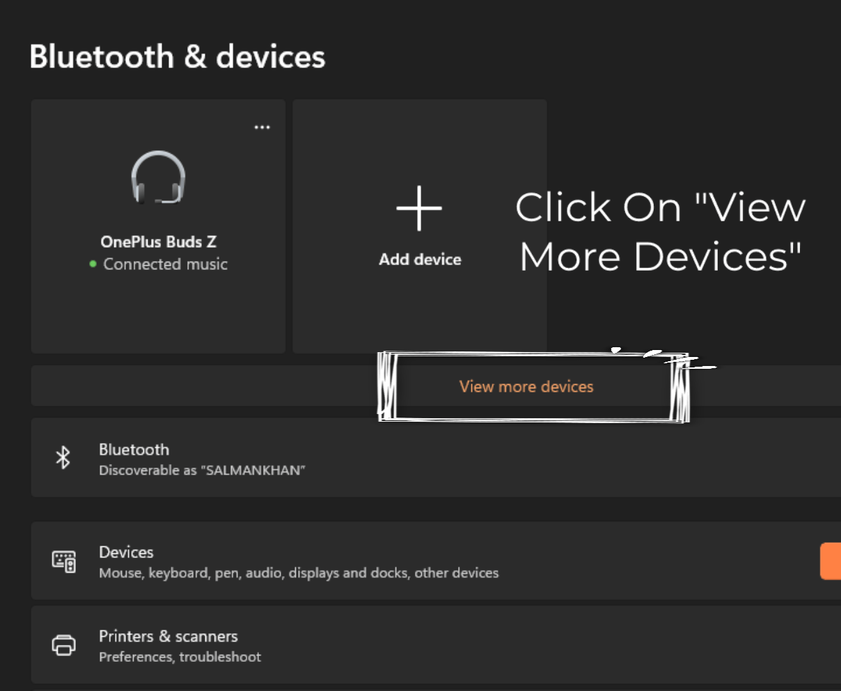

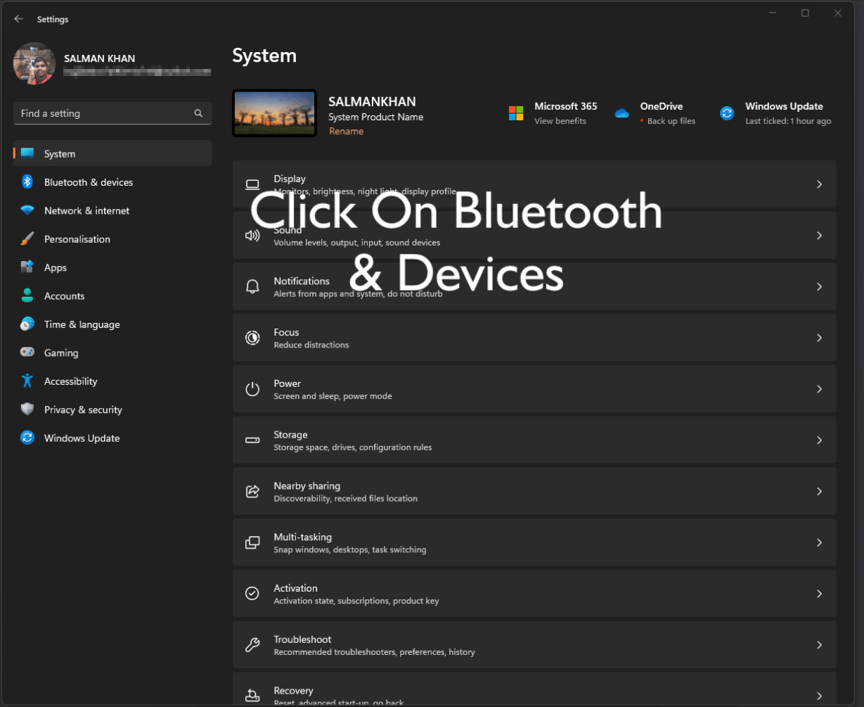

    Step 1: Open Settings & Click On Bluetooth & Devices.
    How to fix Windows 11 Bluetooth Microphone Not Working When Hands Free Telephony is Disabled? ba91f9a5-8b6f-45e4-8e5d-a1c1c48315b4?upload=true.png

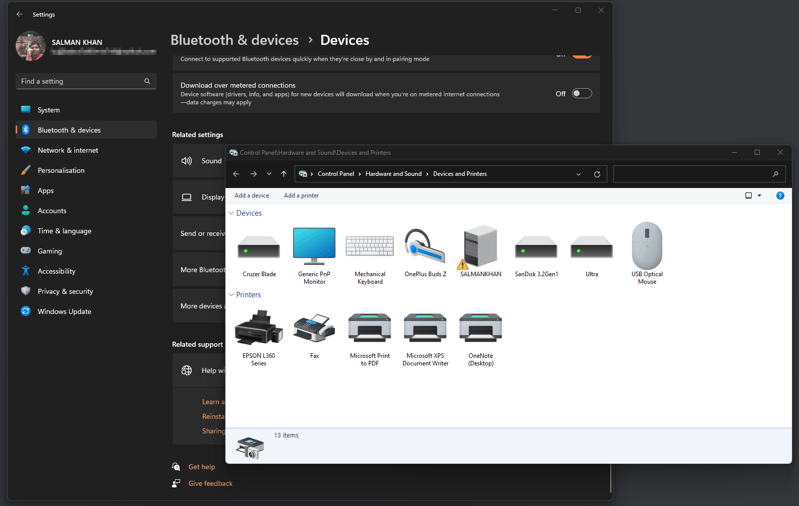

    Step 2: Click On " View More Devices ".
    How to fix Windows 11 Bluetooth Microphone Not Working When Hands Free Telephony is Disabled? 7107d502-5c26-479f-80c5-9e1ab63f18f8?upload=true.png

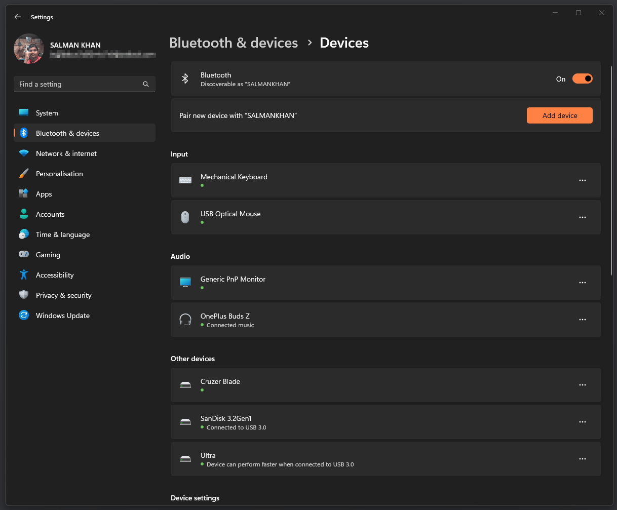

    A page, as shown in the below image, appears.
    How to fix Windows 11 Bluetooth Microphone Not Working When Hands Free Telephony is Disabled? 17fdcc7e-03b1-40f5-8f63-3527145904e9?upload=true.png

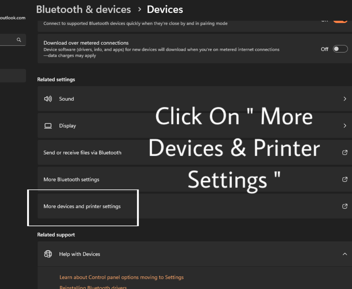

    Scroll Down To Find Option " More Devices & Printers Settings.
    How to fix Windows 11 Bluetooth Microphone Not Working When Hands Free Telephony is Disabled? 164c4b72-372c-4221-b372-4c909c6bbbbb?upload=true.png
    Step 3: Click On "More devices and printer settings"
    How to fix Windows 11 Bluetooth Microphone Not Working When Hands Free Telephony is Disabled? 3e13a928-516e-44ca-890b-9acdbced9321?upload=true.png

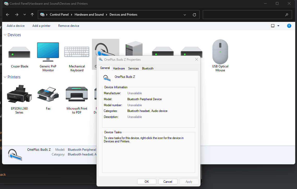

    It will greet you with the windows shown below.
    How to fix Windows 11 Bluetooth Microphone Not Working When Hands Free Telephony is Disabled? e2c9bf05-e4b8-4c68-b129-8bd314fb7cd3?upload=true.png

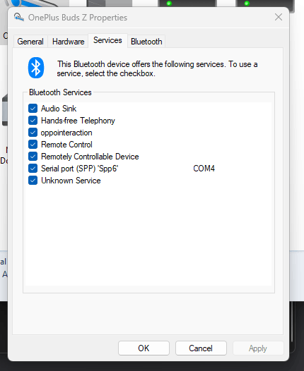

    Step 4: Double Click on the audio device.
    In my case, I am using Oneplus Buds Z. It will open a new Windows of the audio device's properties, as shown in the below image.
    How to fix Windows 11 Bluetooth Microphone Not Working When Hands Free Telephony is Disabled? 497d6fd5-db62-41e2-af28-b1bf598e4d16?upload=true.png

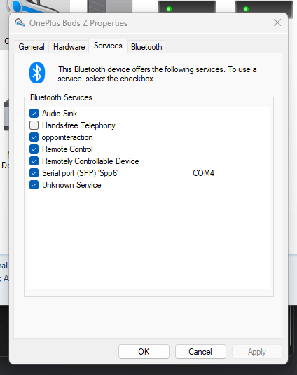

    Step 5: Click on the Services Tab.
    How to fix Windows 11 Bluetooth Microphone Not Working When Hands Free Telephony is Disabled? 21d3cea2-c684-41f6-aad1-28dc7ce3c546?upload=true.png
    It will greet you with the options shown above.
    Step 6: Uncheck the Hands-free Telephony.
    How to fix Windows 11 Bluetooth Microphone Not Working When Hands Free Telephony is Disabled? dba94cef-66af-4673-9e42-95ea54437a8b?upload=true.png
    Click on apply, then Turn Off and Turn On Bluetooth.
    There you go. It's been fixed.
    Enjoy Stereo on your audio device.
    Note:
    After disabling Hands-free Telephony, you can't use the mic on video conferencing calls.
    To use the mic, enable "Hands-free Telephony".
    I suggest you pin the Control Panel window on the task manager or create a shortcut to enable and disable it simultaneously. Make sure to turn on & off the Bluetooth. There is no need to restart windows.
