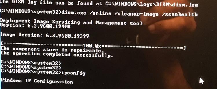

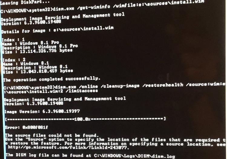

  4. plaurits Win User
    How to Fix Windows 11 Update Error 0x800f081f?
    How to fix DISM error 0x800F081F
    Thanks, yes I already checked that. It references Use DISM to Repair Windows 10 Image. I will try the steps here. Br Peter - - - Updated - - - Hi Tried above procedure, scanhealth says that "the component store is repairable". Command: Dism /Online /Cleanup-Image /ScanHealth However the restorehealth still gives same error 0x800F081F - The source files could not be found, ref http://go.microsoft.com/fwlink/?linkid=243077 Command: Dism /Online /Cleanup-Image /RestoreHealth /Source:wim:E:\sources\install.wim:2 /limitaccess E is the drive letter for the mounted win iso image.
