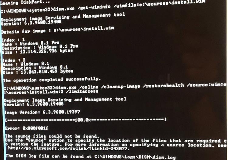

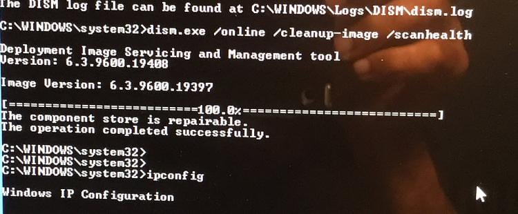

    Hi
    Tried above procedure, scanhealth says that "the component store is repairable".
    Command: Dism /Online /Cleanup-Image /ScanHealth
    However the restorehealth still gives same error 0x800F081F - The source files could not be found, ref http://go.microsoft.com/fwlink/?linkid=243077
    Command: Dism /Online /Cleanup-Image /RestoreHealth /Source:wim:E:\sources\install.wim:2 /limitaccess
    E is the drive letter for the mounted win iso image.
    How to fix Windows 11 Update Install Error 0x8007370a?  Ran DISM /ScanHealth and... 368974d1655318209t-how-fix-dism-error-0x800f081f-2022-06-15_20-19-12.jpg
    How to fix Windows 11 Update Install Error 0x8007370a?  Ran DISM /ScanHealth and... 368975d1655318209t-how-fix-dism-error-0x800f081f-2022-06-15_20-20-01.jpg
    plaurits, Aug 8, 2023
