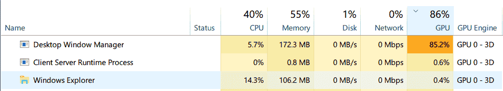

    I always open lots of windows and create many virtual desktops to boost my efficiency, but when I use Win+Tab to switch between windows, it will delay for seconds to load the view. I look at the task manager and found that my GPU goes crazy.
    How to force dwm.exe to use the discrete graphic card? deb89f3c-874b-4cc1-ae7e-7ee811b0c5b1?upload=true.png
    How to force dwm.exe to use the discrete graphic card? d0cdc55a-a352-463b-b68b-d3a1ca7cecdd?upload=true.png
    This is what happens after I press Win+Tab. The dwm.exe uses 90% integrated GPU and the discrete graphic card is "having fun". That's the reason for the delay.

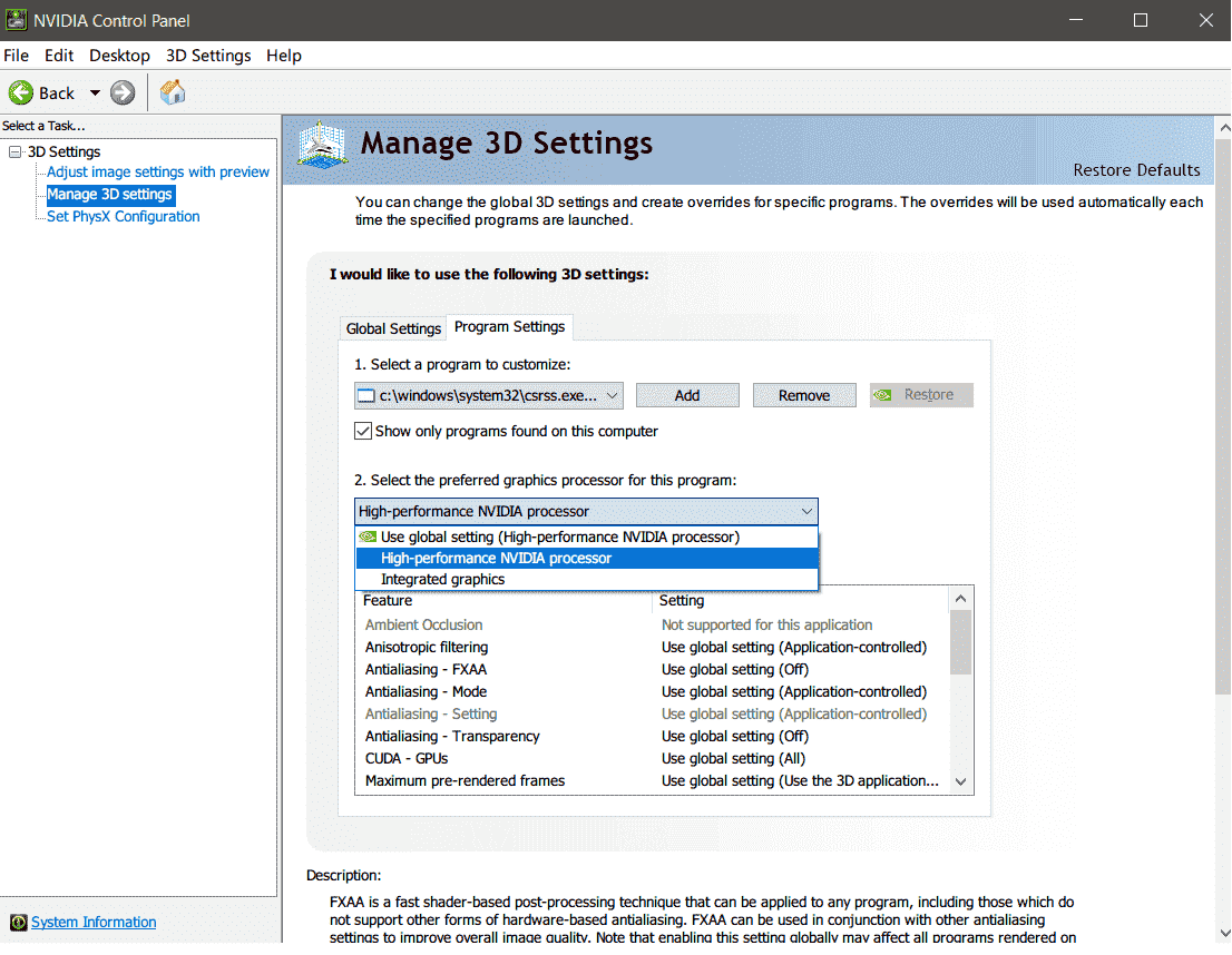

    In the control panel, you can see that only dwm.exe does not support high performance GPU but any other program works.
    How to force dwm.exe to use the discrete graphic card? 3dfb6d22-f81e-4d2f-9dac-c91d2998ff20?upload=true.png

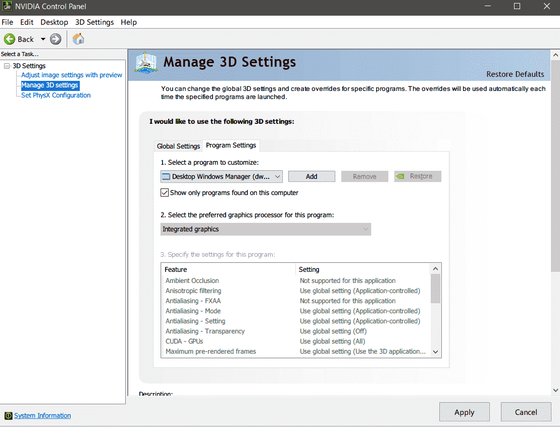

    How to force dwm.exe to use the discrete graphic card? 2bae903b-e139-400c-b53f-f69e2733d8d1?upload=true.png
    The "Select the preferred balabala" is gray for dwm.exe.
