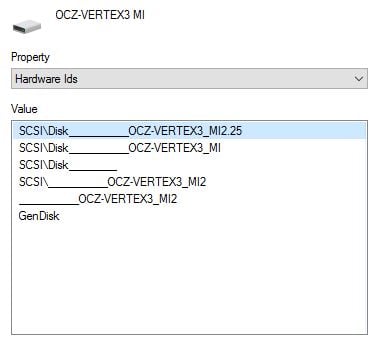

  3. EdTittel Win User
    identify unknown device
    Go into DevMgr, open unknown device, click on properties, open the Details tab, then post the values you find in the Hardware IDs field. For example, for an OCX Vertex 3 drive on my system, here's what I get:
    How to identify bluetooth 'unknown device' 105047d1485972726t-identify-unknown-device-ov3-hwids.jpg
    Let us know what you find when you do likewise. (Hint: you can search on this information in Google to identify devices yourself, too.)
    HTH,
    --Ed--
