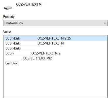

    Go into DevMgr, open unknown device, click on properties, open the Details tab, then post the values you find in the Hardware IDs field. For example, for an OCX Vertex 3 drive on my system, here's what I get:
    How to identify bluetooth 'unknown device' 105047d1485972726t-identify-unknown-device-ov3-hwids.jpg
    Let us know what you find when you do likewise. (Hint: you can search on this information in Google to identify devices yourself, too.)
