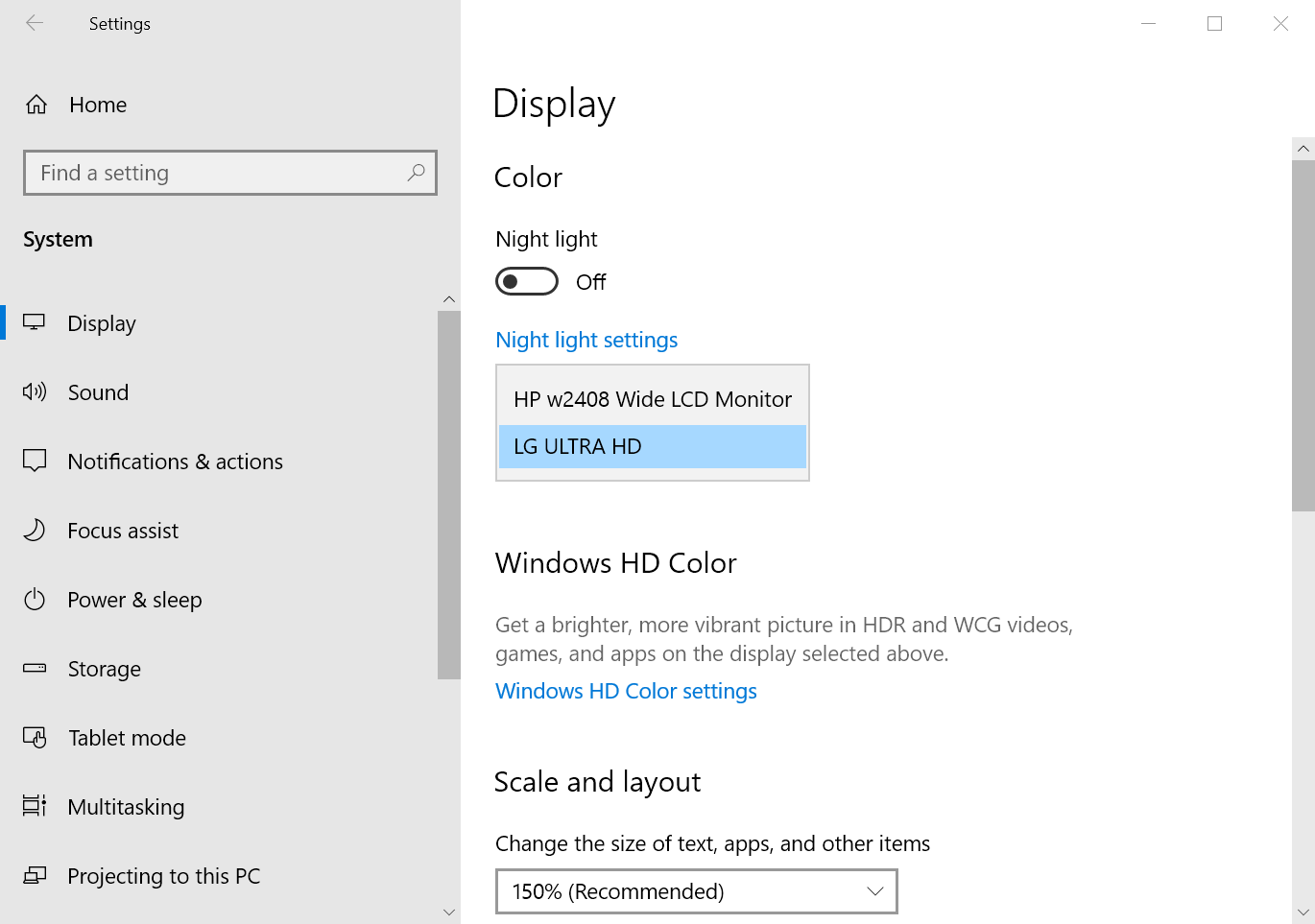

    You may notice that an incorrect color profile is installed by opening Settings and going to System > Display. There you find the color profile section and it if lists a different monitor, the wrong profile is installed. You may also check Color Management (see below) for detailed information.

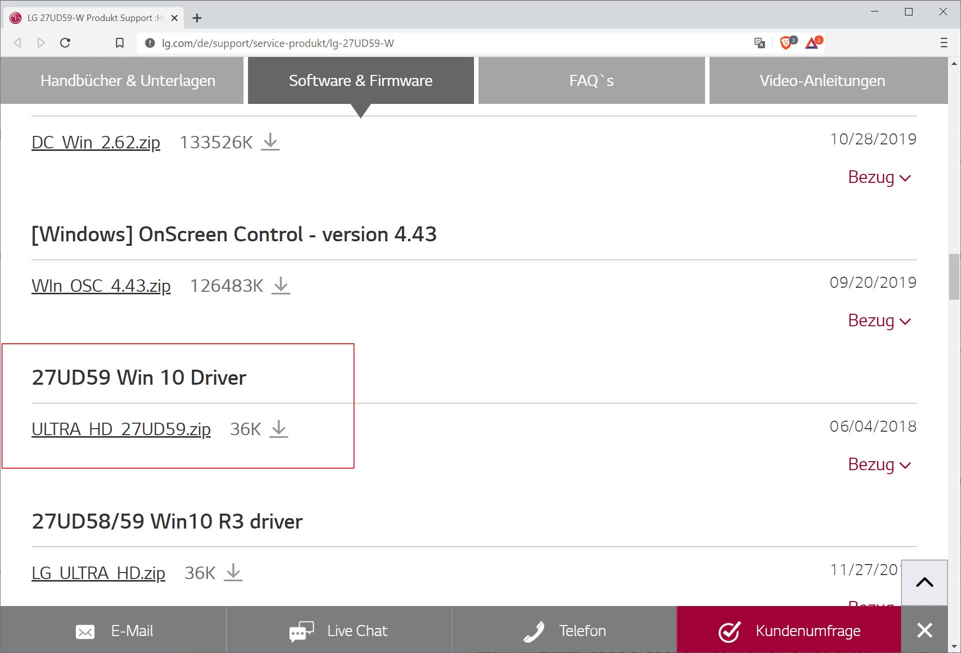

    Usually, it is the manufacturer that provides the right color profile for the monitor. If your display came with a setup CD, chance is good that you find the color profile file on the disc. Search for a file with the .icm ending in that case.
    If you don't have a disc or cannot use a disc on your system, you need to visit the website of the manufacturer to download monitor drivers as they usually include the color profile.
    It is probably easiest to run a search for "monitor name" Windows 10 driver or similar. I ran a search for LG 27UD59-W 4 windows 10 driver which brought me to the LG homepage from where I was able to download the driver.

    Once you have downloaded the correct driver you may need to extract it first; this was the case for the LG driver for Windows 10 which had a size of less than 50 Kilobytes.
    The package included four files of which one was the ICC Profile that I needed to set the right color profile on the Windows 10 device.

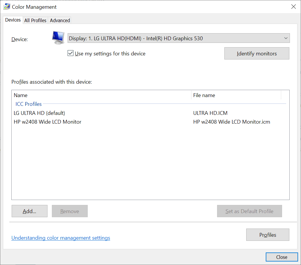

    Right-clicking on the driver and selecting "Install Profile" did not work somehow which meant that I had to use Color Management to install the right color profile on the device.
    Color Management is quite hidden currently on Windows 10. You can try and type Color Management in Start to load it, or use Windows-Pause to open the Control Panel, select Control Panel Home, switch to small icons, and run Color Management from there.
    To install a new profile, select the Add button, browse to the location of the .ics file on your computer and select it. The profile is added but not set as the default profile automatically.
    Select it in the list of profiles and activate the "set as default profile" button afterward to make it the default. You may also use the remove button to remove the old profile in case you no longer need it.
