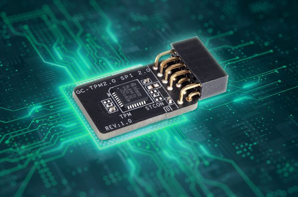

    What is TPM 2.0?
    As mentioned above, TPM stands for trusted platform module. It's a chip designed to secure your device from any malicious software. It's a handy feature and Microsoft has therefore insisted that only systems with this chip get the Windows 11 upgrade. However, this has prevented people with more powerful computers to upgrade to Windows 11, despite meeting the system requirements.
