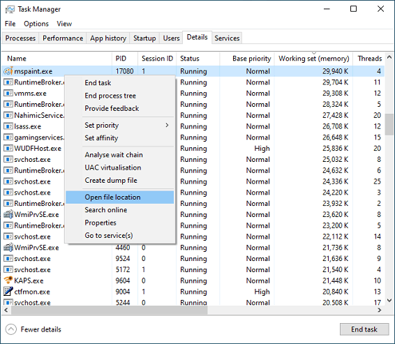

    1. Open Task Manager and click on the Details tab then select Open file location.
    How to Permanently Set Priority & Affinity 6905e3c9-68c6-4538-aa9c-7ae9515fb976?upload=true.png

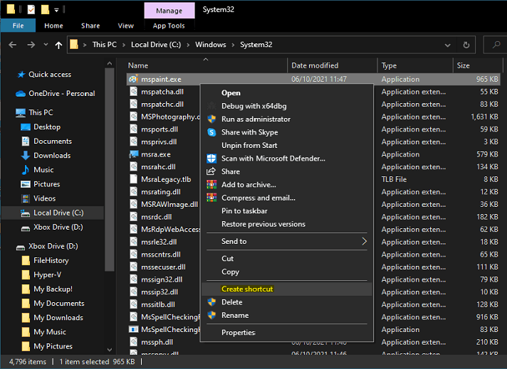

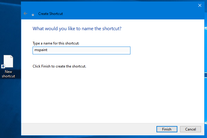

    2. Right-click on the program.exe and select Create Shortcut.
    How to Permanently Set Priority & Affinity f97b3624-e020-4860-b2c5-0f619ddb115c?upload=true.png

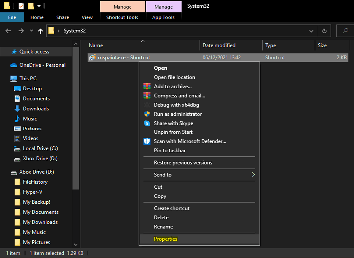

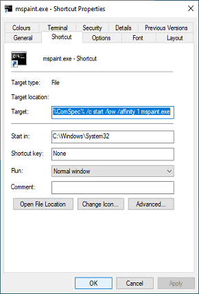

    3. Right-click again on the program shortcut and select Properties.
    How to Permanently Set Priority & Affinity 57e09d3b-9be2-415b-8e98-507852d75ae1?upload=true.png

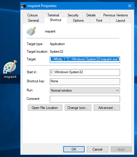

    4. In the target location, enter this command line and set the priority and affinity.
    How to Permanently Set Priority & Affinity 5663a742-1c1c-4c0b-9726-faba42b30b46?upload=true.png
    Target Location:
    %ComSpec% /C Start /Normal /Affinity Hex C:\Folder Path\Program.exe
    Set Priority:
    High
    AboveNormal
    Normal
    BelowNormal
    Low
    Set Affinity:
    CPU - HEX
    0 ---- 1
    1 ---- 3
    2 ---- 7
    3 ---- F
    4 ---- 1F
    5 ---- 3F
    6 ---- 7F
    7 ---- FF
    8 ---- 1FF
    9 ---- 3FF
    10 --- 7FF
    11 --- FFF
    12 --- 1FFF
    13 --- 3FFF
    14 --- 7FFF
    15 --- FFFF

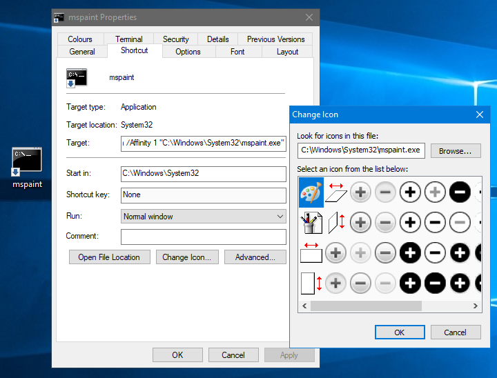

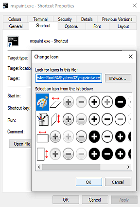

    5. Click on the Change Icon and find the icon.exe path location.
    How to Permanently Set Priority & Affinity 3edc1ee9-974f-4f22-a56c-2b82819f1ce8?upload=true.png

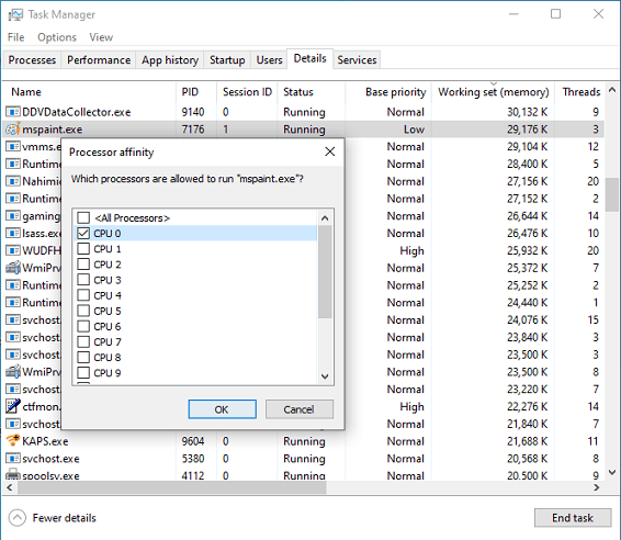

    6. Open Task Manager and the program.exe priority & affinity are set.
    How to Permanently Set Priority & Affinity 56fdb7c3-740f-4c36-abcd-b60797fd6ea3?upload=true.png

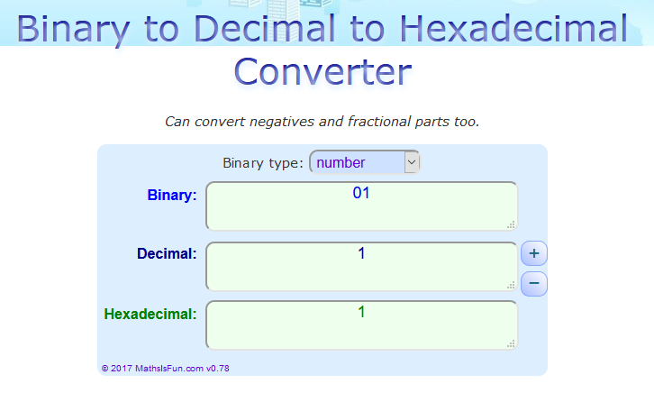

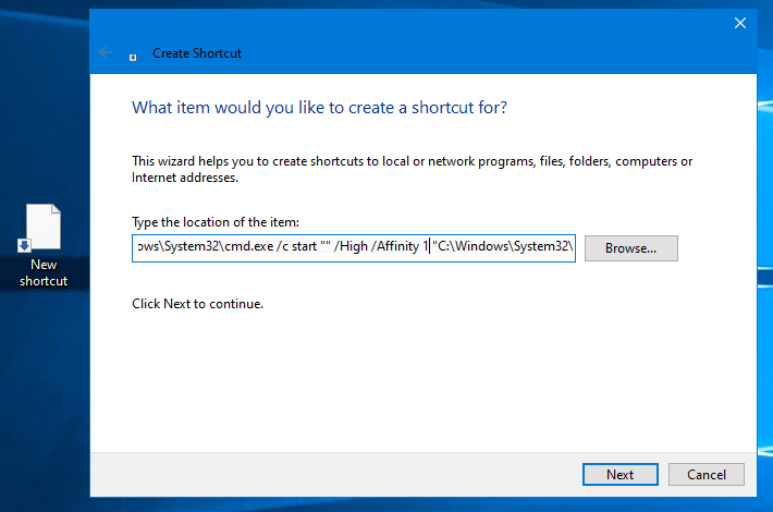

    I use batch scripts to set the affinity and priority.
    How to Permanently Set Priority & Affinity 255864d1574150477t-how-permanently-set-cpu-affinity-programs-screenshot-191119003-.png
    Binary/Decimal/Hexadecimal Converter
    Code:
    You can also create a shortcut on the Desktop:
    Code:
    Target Location:
