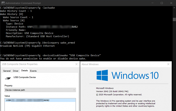

  4. Elenkhos Win User
    How to prevent a device from waking up PC?
    How to prevent USB Composite Device from waking up the computer
    I'm having trouble with a certain USB Composite Device waking up my computer when I don't want it to wake up. I have tried all tutorials that I found with Google but none of them solved the problem. Below is a screenshot that should contain all the relevant info. I would appreciate if someone could give me a hint or suggestion how to prevent this device from waking up the computer. I can't disable wake timers completely because the Ethernet device has to be able to wake up the computer.
    How to prevent a device from waking up PC? ent-usb-composite-device-waking-up-computer-2021-02-08_15-16-06_cmd_administrator_command_prompt.png
    Elenkhos, Jun 20, 2023
