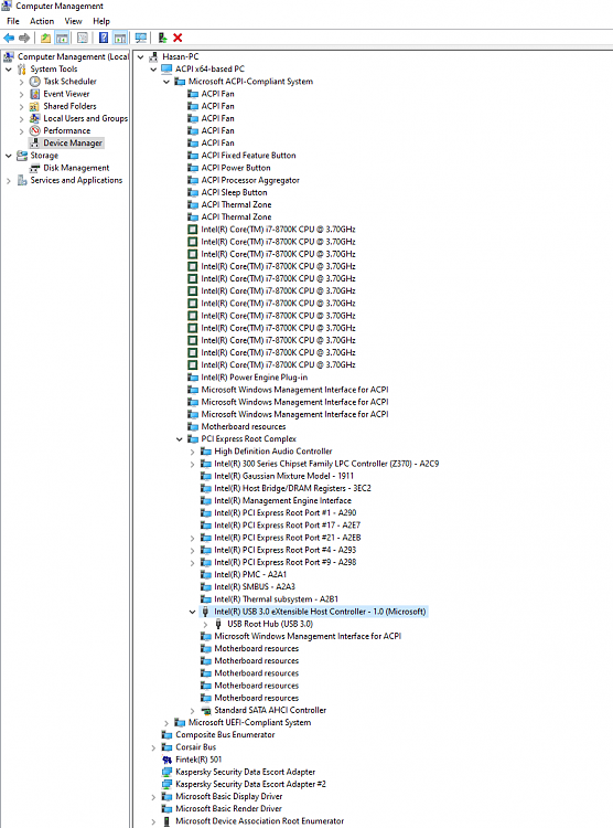

  2. ITGM Win User
    How to completely remove a Bluetooth device from Win 10?
    How to remove a device completely from Windows Bluetooth 281204d1590936405t-how-completely-remove-bluetooth-device-win-10-a-02.png

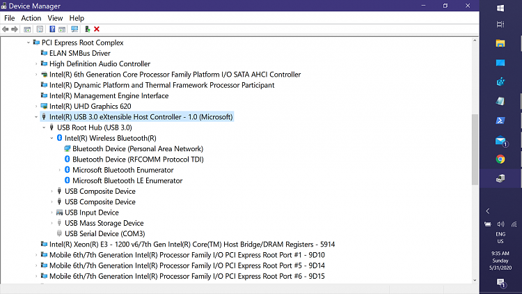

  4. KeithM Win User
    Hmmm...Mine looks like this:
    Code:
    If you:
    1. open Device Manager
    2. Show Hidden Devices
    3. Expand Universal Serial Bus Controllers
    4. Select USB Host Controller
    5. Switch view to Show Devices by Connection
    6. Expand and capture a screenshot.
    How to remove a device completely from Windows Bluetooth 281203d1590935776t-how-completely-remove-bluetooth-device-win-10-a-screenshot-761-.png
    KeithM, Dec 22, 2023
