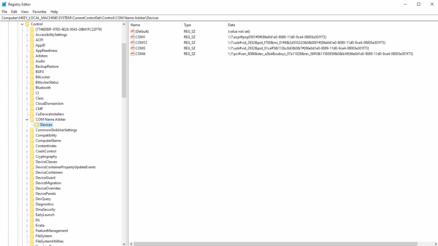

    I looked into the Registry @ HKEY_LOCAL_MACHINE\SYSTEM\CurrentControlSet\Control\COM Name Arbiter\Devices and there are no listings for COM0, so I don't even know where the ghost devices are being stored...

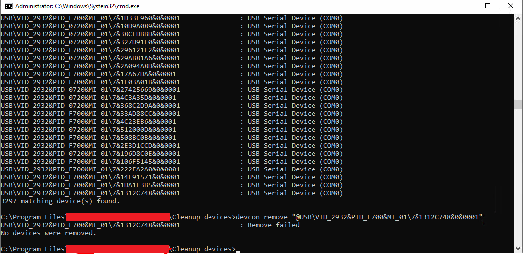

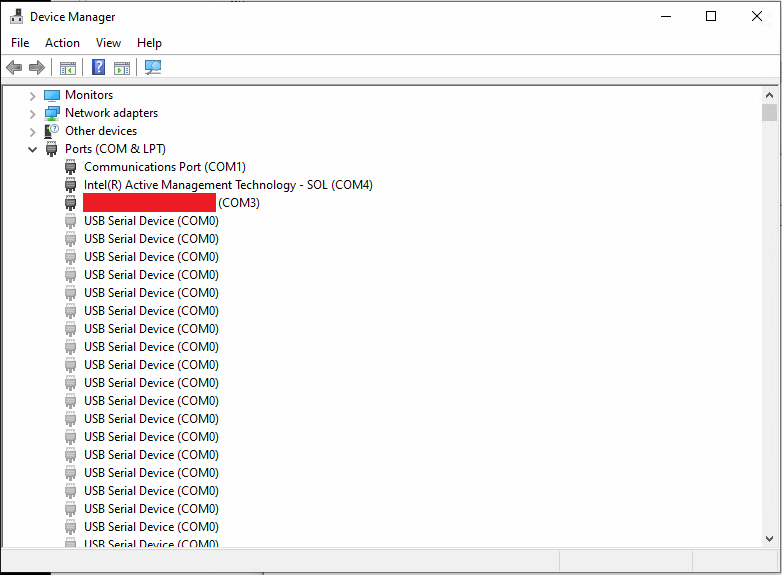

    I came into an issue where I have exhausted all available COM ports (1 to 4096) and all new devices are being added as COM0 (I have around 3,000 disconnected/hidden devices as COM0).
    Using pnputil and devcon I was able to script removing all of the disconnected devices on COM ports 1-4096. However, I have been unable to remove any of the devices on COM0, either through devcon or by manually removing the device through Device Manager. If I try to change the COM port number in the device manager advanced settings it causes device manager to crash.

    *** Solution ***
    After playing around a lot I found a tool that helped me get rid of them.
    I used a tool I found called Ghostbuster ( Bitbucket ).
    Using this I was able to remove all of the ghosted COM0 ports. I believe the remnants are somewhere in the registry and this tool was able to clear them from the registry.
